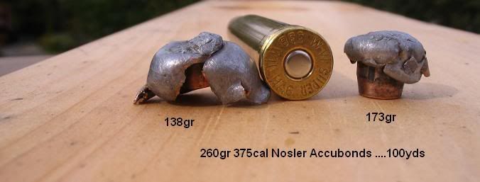

So this may be a bit off topic but to those on here with experience - how does a 260gr NAB perform out of a 375 H&H on game?
Small bull moose broadside lung shot. I was surprised that they wouldn't pass through. Bull never flinched either shot. I laugh when people talk about dropping moose one shot, spine shot maybe but not a lung shot.
You & me both. Any details Paul, as far as distance, calibre, load including bullet specifics etc?
Really? I've had more drop at the shot than not, just using the same bullets that some are convinced are too soft for deer and muzzle velocities of 3000 plus. Sometimes plus 500. The two slowest kills were with a .300 and .338 Win Mag and the darling of the mono-bullet crowd.
