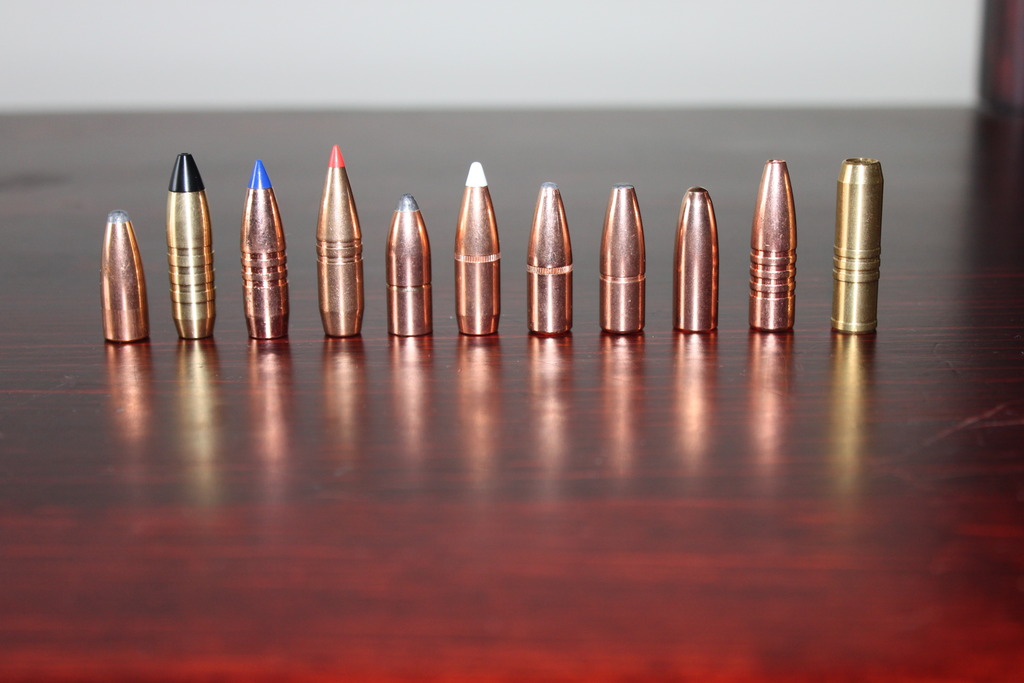

Here's the moment you have all been waiting for!
- The impact velocity was made to duplicate .375 Ruger and .375 H&H loads at 100 yds.
- Expansion was measured at the widest part of the bullet. Take a look at the pictures when comparing the expansion of different bullets, sometime a sliver of lead or copper at an odd angle can give deceptive results.
- Test rifle: Ruger Alaskan .375 Ruger
- Test media: Wet newspaper....lots of wet newspaper!!
- Disclaimer: I know wet newspaper does not give identical result to flesh and bones, blah, blah, blah....

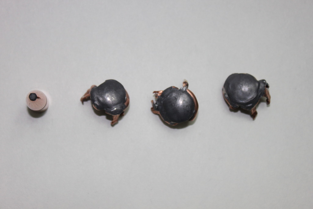

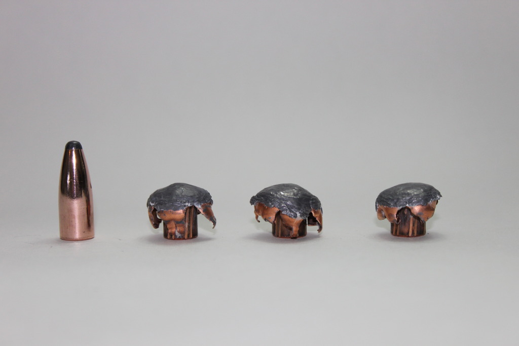

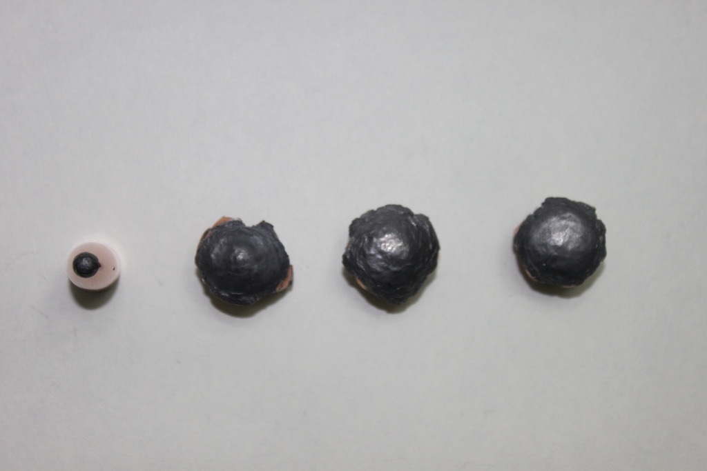

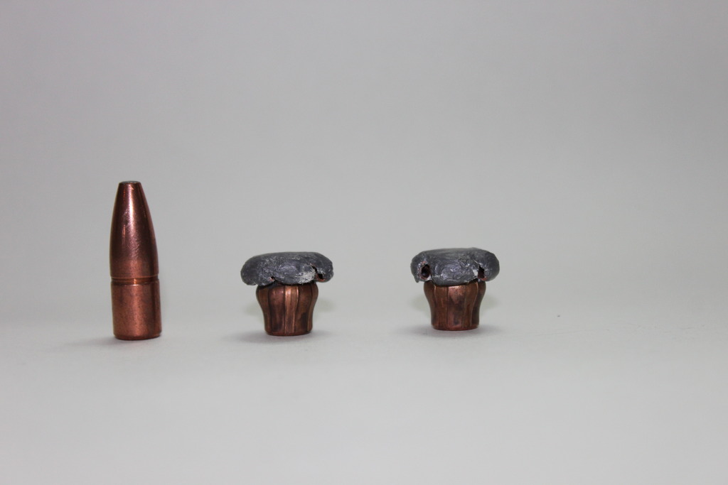

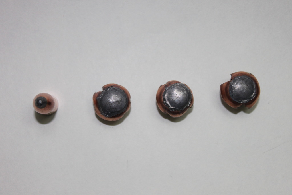

Speer 235gr HC
Average Penetration (inches): 15
Average Weight Retained (grain): 200.5
Average Weight Retained (%): 85.3
Average Expansion (inches): 0.764
Note: Impressed with this little cup and core bullet. Great penetration and retained weight. No sign of the core slipping.

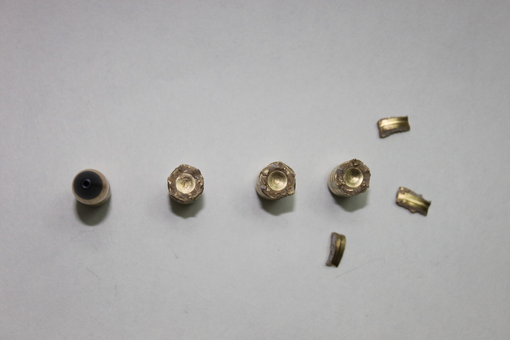

CEB 235gr Raptor
Average Penetration (inches): 23.8
Average Weight Retained (grain): 182.4
Average Weight Retained (%): 77.6
Average Expansion (inches): 0.409
Note: Crazy penetration for a 235gr bullet. The petals did shear off in a "star" pattern and really shredded the paper for the first few inches then the shank continued for super deep straight penetration.

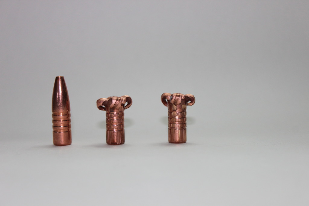

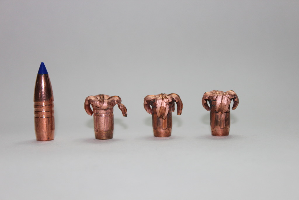

Barnes 250gr TTSX
Average Penetration (inches): 18.3
Average Weight Retained (grain): 246.1
Average Weight Retained (%): 98.4
Average Expansion (inches): 0.738
Note: Typical TTSX performance.
Bonus Pic! Recovered 250gr TTSX from a bull moose shot at 355 yds.

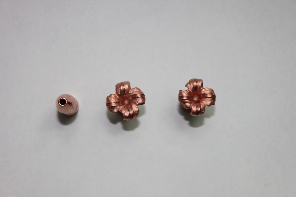

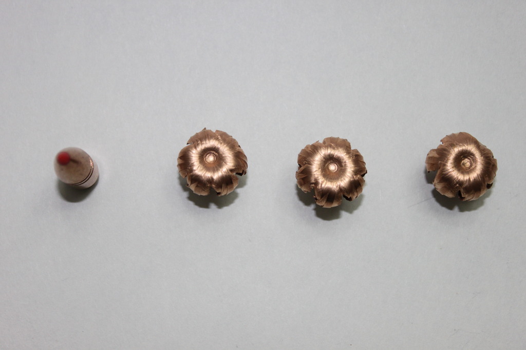

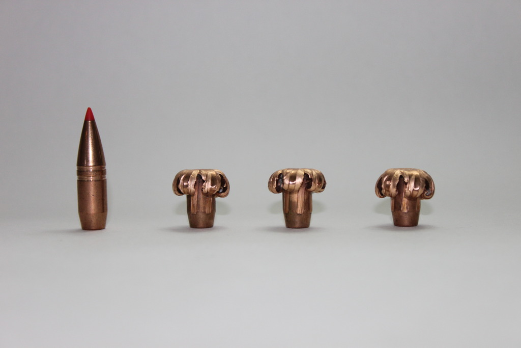

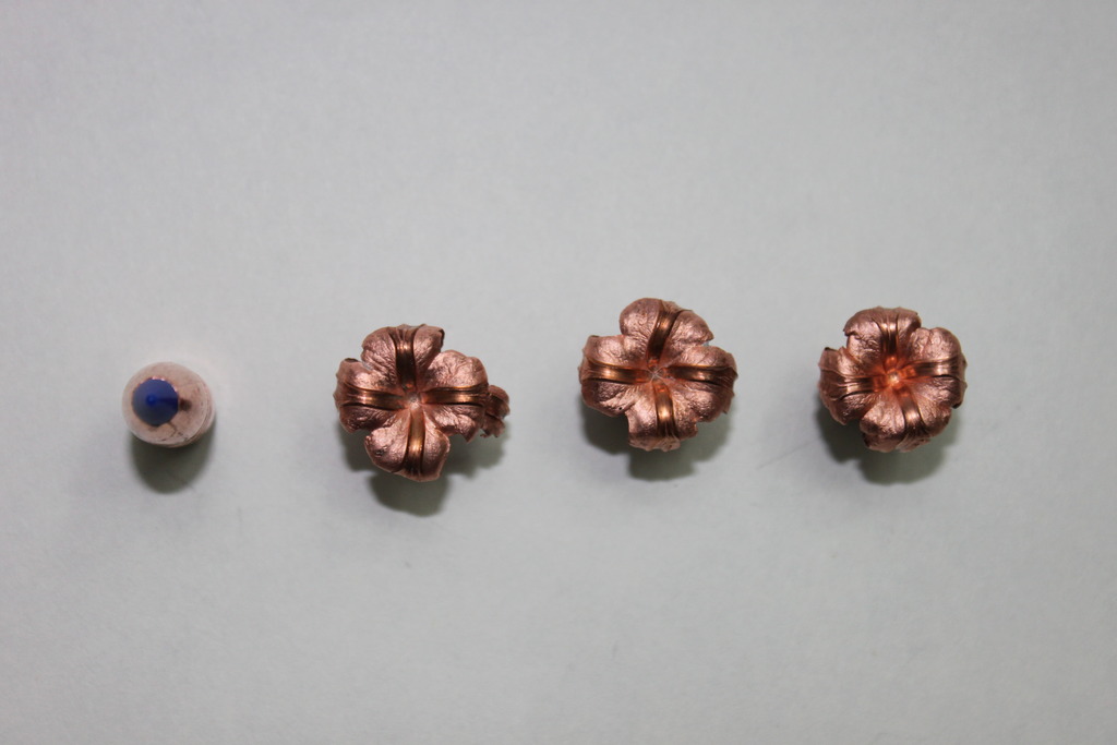

Hornady 250gr GMX
Average Penetration (inches): 19.5
Average Weight Retained (grain): 247.4
Average Weight Retained (%): 98.9
Average Expansion (inches): 0.753
Note: If this was a beauty contest, the GMX would win for sure. Very impressed with this bullet. I was surprised that it expanded deeper in its hollow point than the TTSX since the TTSX is supposed to expand to lower velocity. I haven't shot any game animal with anything but Barnes bullets in over 10 years but I might have to try the GMX next year!

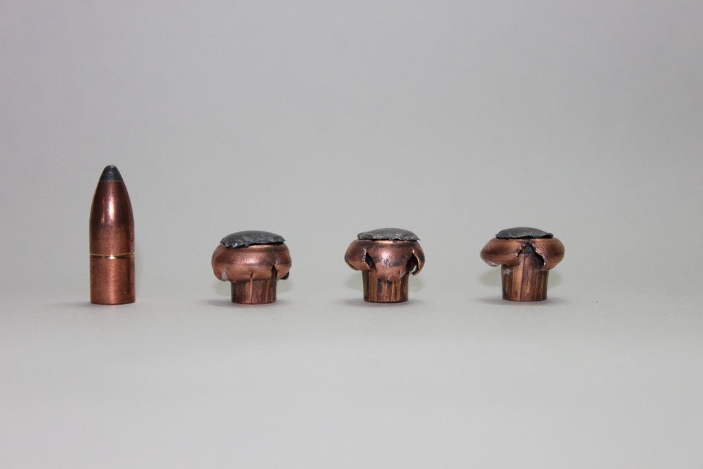

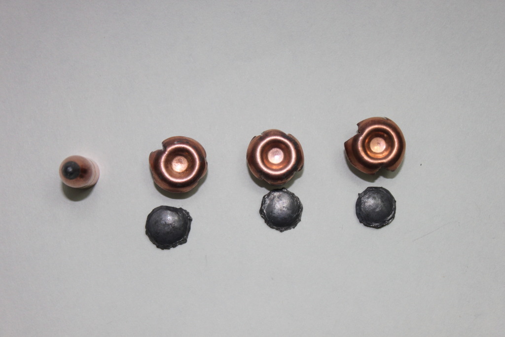

Nosler 260gr Partition
Average Penetration (inches): 17.83
Average Weight Retained (grain): 207.3
Average Weight Retained (%): 79.7
Average Expansion (inches): 0.690
Note: Typical Partition performance. The top lead portions are just sitting on top of those bullets, they are no longer attached.

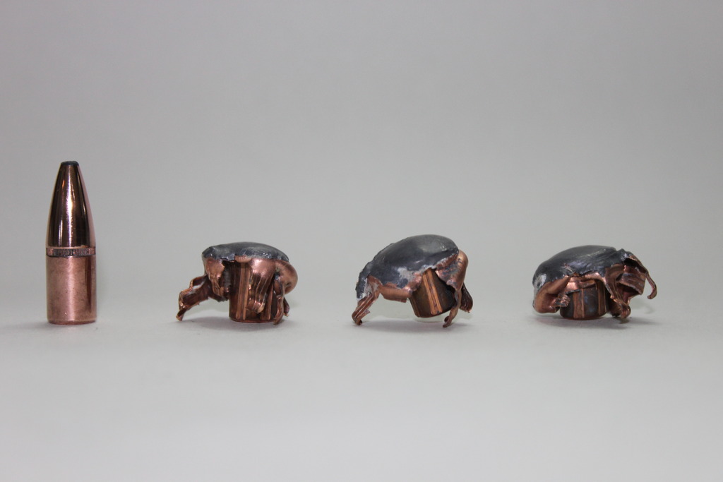

Hornady 270gr Interlock
Average Weight Retained (grain): 228.7
Average Weight Retained (%): 84.7
Average Expansion (inches): 0.90
Note: Very impressed with this plain vanilla cup and core. If you compare it to the Partition, it penetrated deeper, retained more weight and expanded wider! No sign of the core slipping.

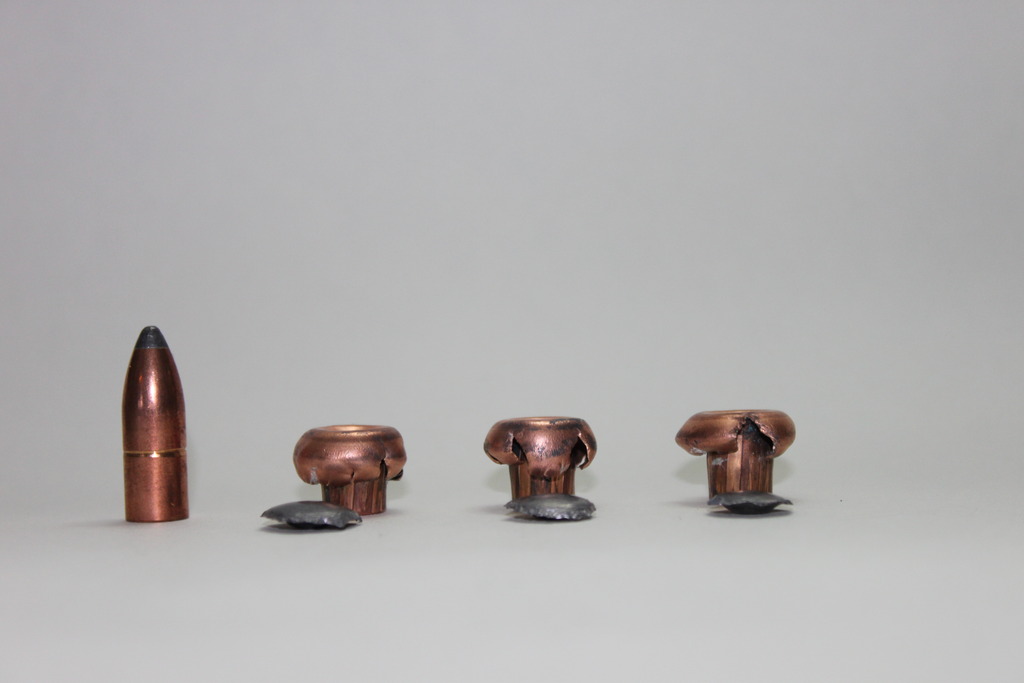

Swift 270gr A-Frame
Average Weight Retained (grain): 266.2
Average Weight Retained (%): 98.6
Average Expansion (inches): 0.71
Note: Probably the most consistent performer of all. Each bullet look identical, weigh the same, etc... One slipped out of the stack.

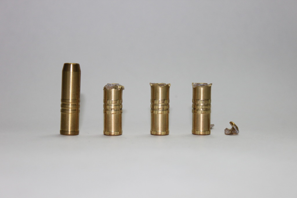

CEB 270gr Safari
Average Penetration (inches): 23.2
Average Weight Retained (grain): 197
Average Weight Retained (%): 73
Average Expansion (inches): 0.418
Note: Similar in performance to the 235gr Raptor despite weighing 35gr more and a very different profile.

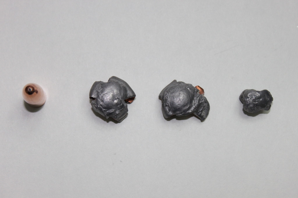

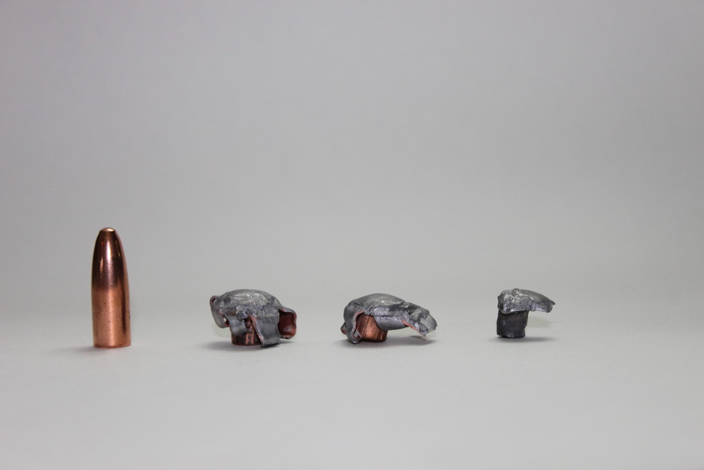

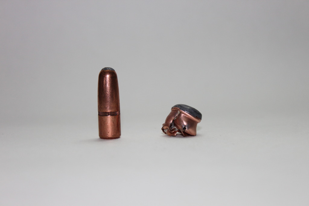

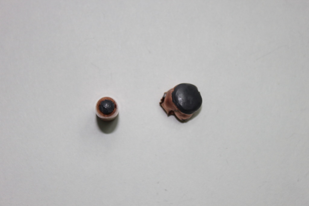

Hornady 300gr Interlock RN
Average Weight Retained (grain): 167
Average Weight Retained (%): 55.7
Average Expansion (inches): 0.581
Note: Factory ammo, not loaded down. Was running out of fresh newspaper and this is the only one I was able to recover. Disappointing performance for a 300gr bullet compared to the other lighter cup and core tested.

Very interesting test. I'd be interested to see the actual velocities though that's not really critical. Did you lose the other 300gr RNs? I was surprised at how much weight it lost. I was also surprised to see what looks like a core separation on the 270 Matrix. Not surprised that stalwarts like the TSX, A-Frame and Partition performed as they did but some of the less well regarded cup-and-core specimens like the Hot Cor and Interlock gave surprisingly good results. I don't think that I particularly want to hunt those CEBs personally. Tiny lightweight fragments going madly off in unpredictable directions doesn't inspire much confidence, in my opinion. Maybe I'm an old Fudd, but I like my bullets to hang together and go in a straight line when they hit something.

A bit more than I think they should, and those CEBs? I would rather use a good solid.

Wow that barnes tsx with almost 100 percent weight ...great bullet. That's what I like to see a bullet that stays in one piece. Over 99 percent weight retention. Dutch
