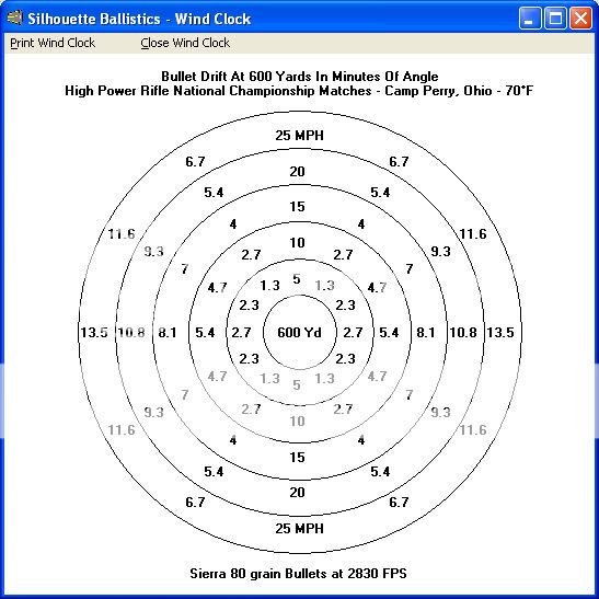

I should also mention that I had a NEW sponsor email me with a donation. I was very surprised since I did not solicit this company. I looked at his web site and this bal pgm has the Wind Clock in it! My hat is off to this guy for stepping up and offering a donation! Thank you very much! This is a very good diagram to have on the line with you when the wind swings!

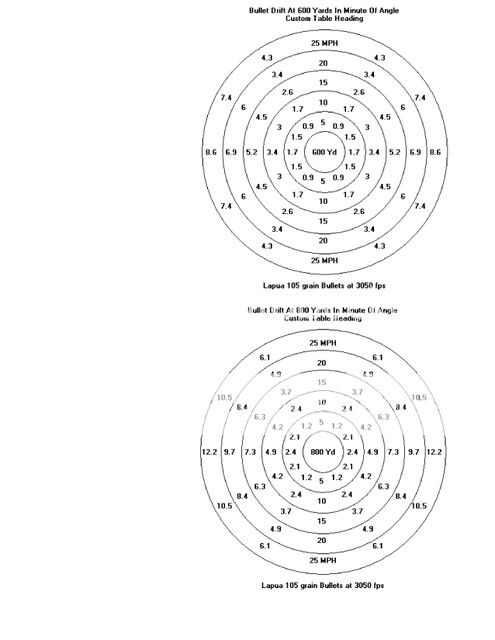

This one is for a 223 with a 80g based on the velocity
Mine.. at 600 and 800, same program, printed as PDFs then joined in Photoshop for my book

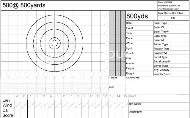

Above is a 500 yd target at 800 yds on a grid plot sheet to give you an idea of the targets used. The V bull is the dotted line and is a hair over 1/2 moa, the 5 ring is a hair over 1 moa, the black rings go out to the 3 or the aiming mark of 39" on the 500 yd DCRA target, the 2 ring is in white. Each grid square is a true minute. I have a set of plot sheets for all competitors, 300M at 600, 500 yd @ 800 and the 500 yds at 1000. It will help you find the center after your sighter, in minutes. Yes it is looks like a big target board, 10 moa by 6+ moa, but trust me, you will need it if the winds are bad. The circles on the right side and bottom are for your wind and elevation setting you put on your rifle. It is up to you if you want to use the plot sheet, but good notes come in handy. You can draw a pic of the flag your shooting on, or the direction of the wind, or whatever in the Call if you want, just don't get buried in paperwork, your there to shot and have fun too :)
