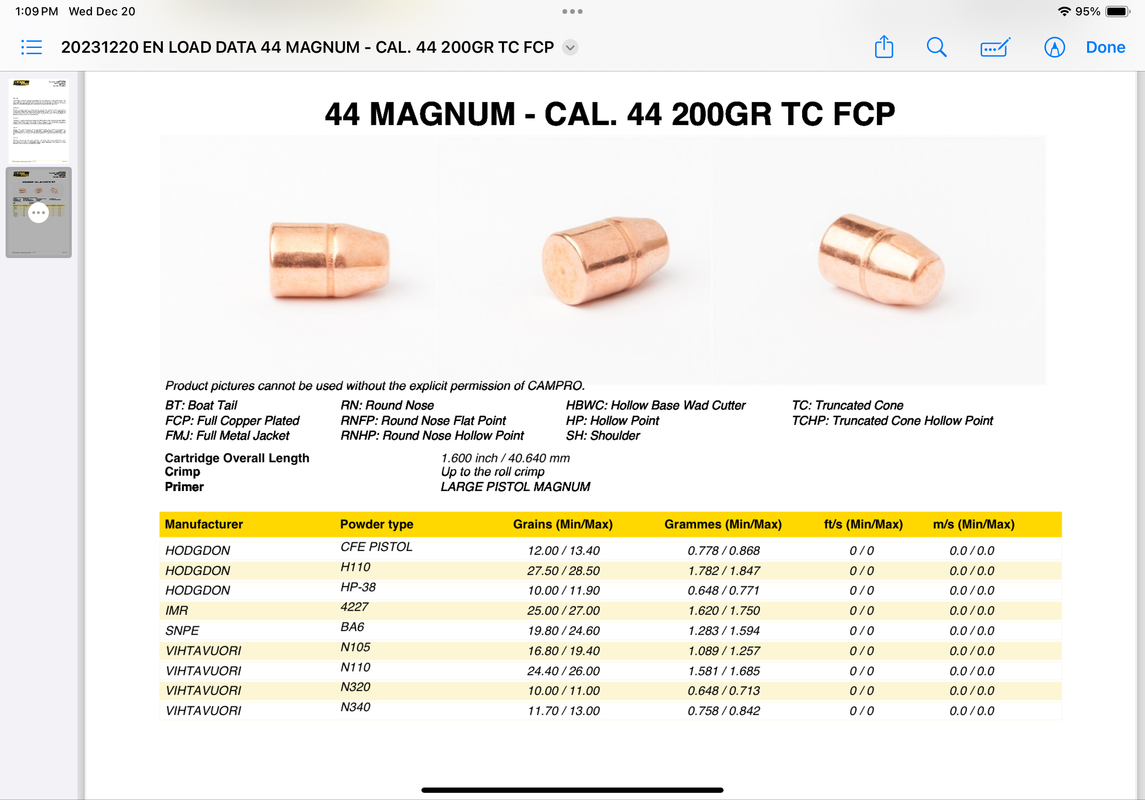

Anyone know of some load data for the 200 grain CamPros?? Thanks .... For use in a rifle .... CVA scout.
I can't vouch personally as I load the 240gr Campros (11.0gr CFE Pistol), but will the load data on CamPro's website not work for you?
h ttps://www.campro.ca/index.php?id=1021&produit=Cal.%2044%20200gr%20TC%20FCP
ManufacturerPowder TypeGrains (Min/Max)
HODGDONCFE PISTOL12.0 / 13.4
HODGDONH11027.50 / 28.50
HODGDONHP3810.00 / 11.90
IMR422725.00 / 27.00
SNPEBA619.80 / 24.60
VIHTAVUORIN10516.80 / 19.40
VIHTAVUORIN11024.40 / 26.00
VIHTAVUORIN32010.00 / 11.00
VIHTAVUORIN34011.70 / 13.00

THANKS very much!!
This gives you a starting point. Handgun or rifle.
