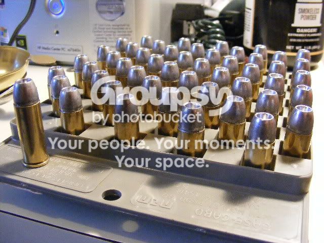

No real point to this thread. I made some new bullets and loaded them in .44 special cartridges, and took some pics to savour my handiwork. I do like the .44 special, it's one sweet revolver cartridge.
I'm a huge fan of the 44MAG and the 44Spl, for me plinking with 44spl loads is just plain fun.
Are those rounds shown crimped yet? Since I load pretty hot sometime, the crimp is really evident.
Also, very nice HP Cast. Just plain cool!

They are crimped into a cannelure.
So one has to ask jethunter: What mold design is that?

It's based on the old Lyman 429640 mould. MP Moulds made some with a Cramer HP system for a group buy on Cast Boolits.com recently. That's where I got this one.

You could also get a pentagram style pin for the mold as well as a flat pin so from the same mold you can have a circle hollow point, a 5 sided hollow point or no hollow point. I can't recommend his molds more than to say they are first rate quality and an absolute joy to use.
I can actually crank out more hollow point bullets with his 2 cavity molds than I can with any Lyman 4 cavity solid mold. Once you pour the lead and the sprue hardens you simply cut the sprue, turn it over, tap the pins and out come the beautiful bullets.
With the typical Lyman 4 cavity you pour the lead, cut the sprue, turn it over and begin to hit all over the mold with your stick, bow three times to the east, exhaust your swear vocabulary and maybe if you are lucky the bullets will come out. I am exaggerating a bit but once you use a high quality mold like Miha's your Lyman molds will get moth balled to the back of the cabinet.

This mould came with 3 sets of pins - penta pins, small HP pins, and large HP pins. The bullets in the pictures weren made with the large HP pins. Flipping any of the pins around also gives you a solid.
