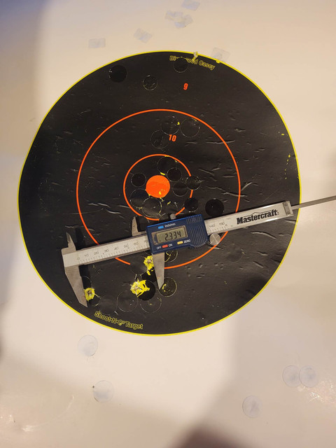

Another factor in my accuracy issue might just be a bad boresight. This is across my kitchen at 10m. It's far worse at 50m. Got the sights aligned now. Just need some more GOEX for a range trip
Curious to know what you had to do to align things? I haven't much faith in most" bore sighters ".In fact I can't recall anyone I happen to know who paid the extra bucks to bore sight a rifle who even came what I would call close to target. Lucky to be on paper at 25 yards most times. not saying they don't work ,just that in my experience they left much to be desired. Lever and closed actions aside I find sand bagging the rifle and sighting a target through the barrel at 25 yards to have worked the best for me and scoped rifles. I have lucked out with most of my iron sight rifles at close range where I could just drift the sights a bit as required. Right now I am struggling on what to do with my 1860 Henry shooting 5 inches high at 50 yards. Groups well though.[not looking to side rail your post]

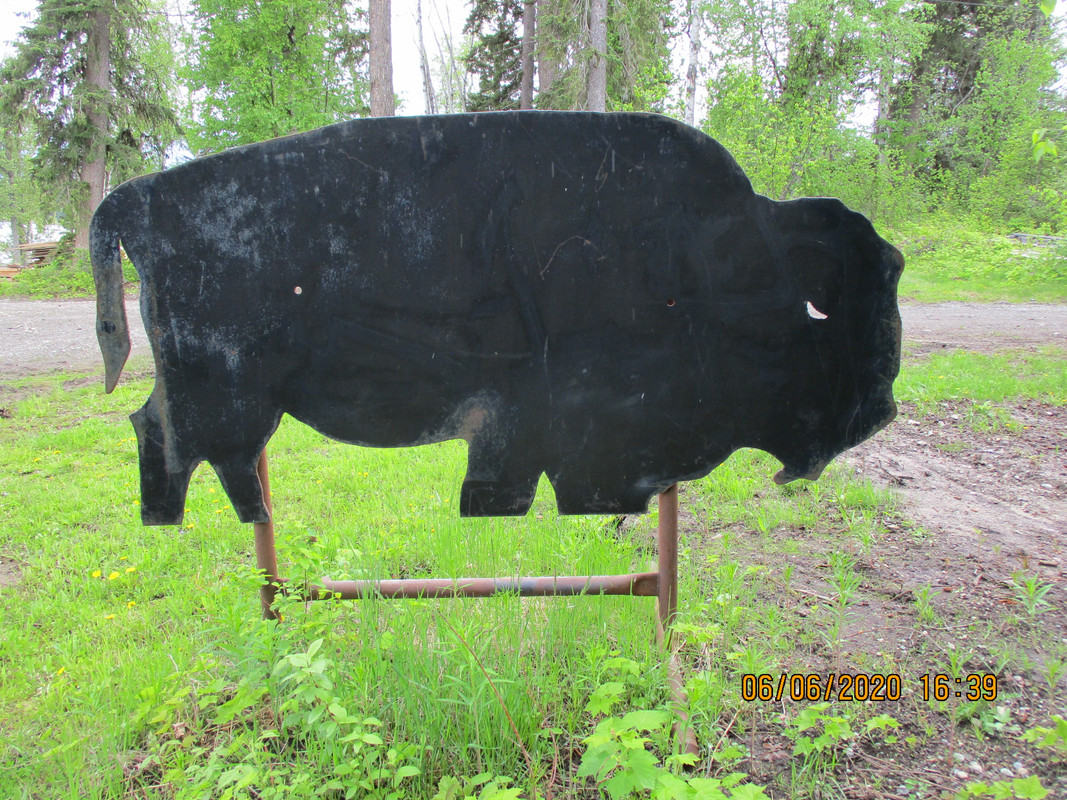

As an avid 45/70 shooter I have learned that there are no short cuts in the quest for distance shooting.
Drop tubes, cleaning between shots, bullet butter, powder volume measure not weight measure, a drink of steamy tea or coffee before blowing down the tube to loosen the fowling, 1235 yards is what I have hit repeatedly with all this testing. Mind you it was shooting at the below target(full sized buffalo).

I had to move the front sight a good chunk to the left. Makes me think the rear sight isn't perfect in the center of the receiver. But if that is the case I'll end up just re centering the front sight and then using the windage to line up the rear again and call that good enough.

With the sight you want to get a little level on the sight and make sure it is plumb forward and side to side. When I put my new sight on, I had to use a few layers of aluminum foil under the left side of the base shim it to where it was perfect. You should be able to loosen the screw on the sight spring to adjust it forward and backwards, then lock it down with the screw. Loctite can't hurt. Get some big poster board or cardboard to get on paper up close, then go out to longer range from there. Swiss powder will always give you better accuracy than Goex. It's what the best shooters use.

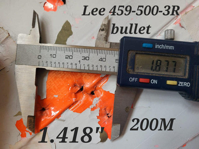

I have found good results with the Lee 500-3R bullet mold at 200M (I haven't tried it further yet)
You can get these molds for $56 here
https://budgetshootersupply.ca/product/lee-mould-459-500-3r-double-cavity/
I was loading with Goex Olde Eynsford, but with some testing I'm sure you could get other powders to shoot well.
The load was 62.5 gr Olde Eynsford 1.5 fg, .02 card, .068 fiber wad, Winchester LR primer, Lee 459-500-3R bullet cast from 50/50 pure lead/wheelweights and lubed with 50/50 beeswax/Shea butter.
The powder is compressed so the OAL has the bullet about .01 from the rifling.

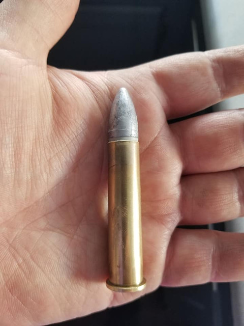

One thing I forgot to mention is that I don't size my brass at all. I just knock out the primers with a universal deprimer, then clean and prime. This only works with brass fireformed to your particular rifle. It won't chamber in another. I just push the bullets into the case by hand.

So, I did more testing today at 200M with that Lee bullet I mentioned before. I can't get the Olde Eynsford I was using anymore, so I tried out the more easily available Schuetzen 2f powder.
I was actually surprised with the good results I got.
The best grouping was with 4 CC of the powder ( about 60.7gr) compressed and a .02 card, .062 fiber wad.
It shot just over 1 MOA from the bench sticks, and the recoil was quite mild.

4.3CC Pyrodex. Ox-yoke wad and a 405gr pill seated to 2.500 (my dies refuse to seat at anything else with these bullets, I'd much rather be at 2.600)
