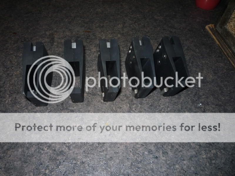

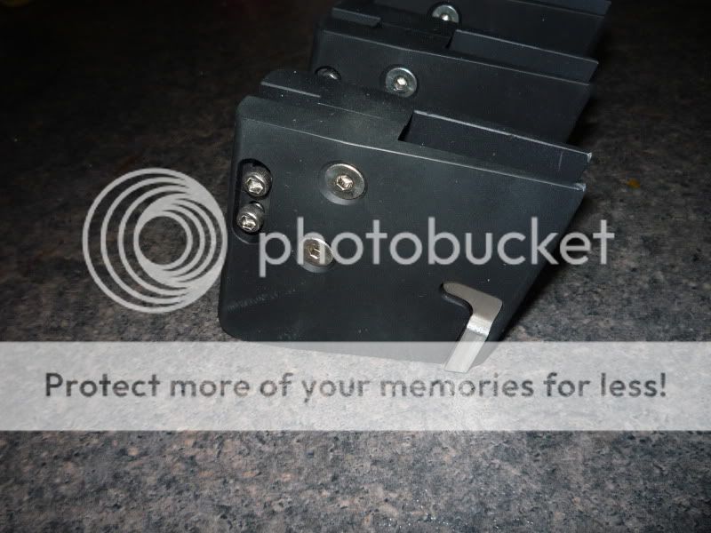

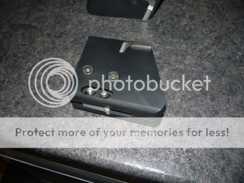

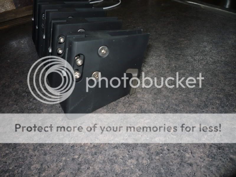

Anymore news or pictures on these, has anyone got one and put it together, starting to get very interested in the idea of building one myself. The only part I can see me having trouble with is removing the barrel.
If anyone is looking for a stock sets for there 45acp convertions, will be making a run of them here in late summer, can make laminated or walnut/beech, cheers Dale Z!
