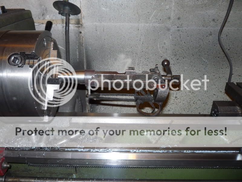

Got 5 bbl blanks and 5 adapters in. Just got word that the bbl nuts and ejector studs are shipped. Will begin machining bbls this weekend, pics to come. Thanks for the patience guys, things should be happening soon.

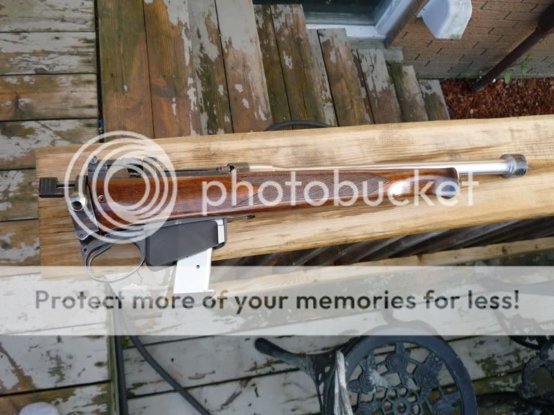

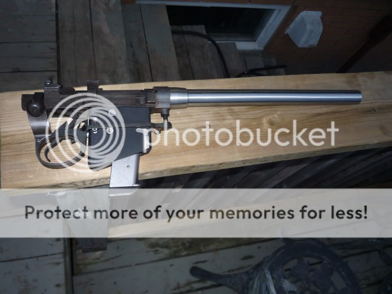

So...I'm making up a few kits that will take a mag adapter and use 1911 mags to feed. Wondering what length of bbl people would like to see. Kit including mag adapter, extraction stud with a 14" bbl and bbl nut. Buyer will need to supply an action and stock as well as the 1911 mag. The bbls will install ala savage with a bbl nut and ar stock nut wrench These kits will be very easy to install by the end user.
Will look like this depending on how you finish it:
