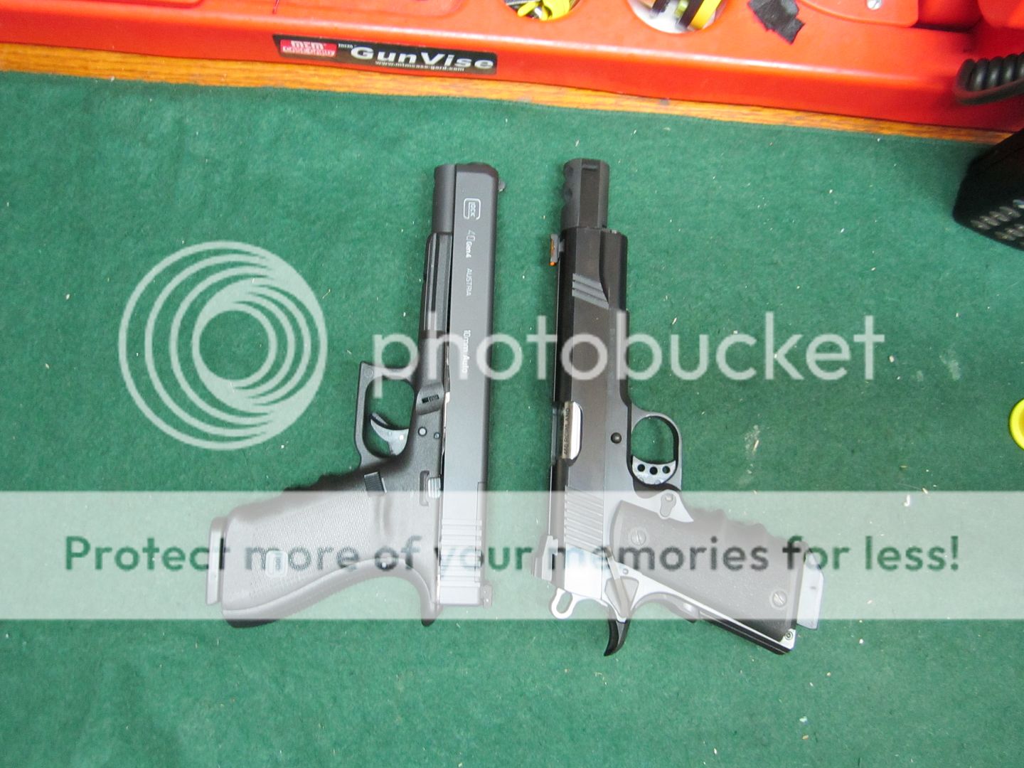

i got mine before the embargo on them and i installed it myself - there is really nothing too it, all your doing is swapping out the barrel which has a comp installed on the end and the spring and a 2 piece guide rod. it does take a bit of strength to put that big spring in but its not too bad.
i actually just had mine out i was comparing it to my brand new G40 to see if there was a size and weight difference.
