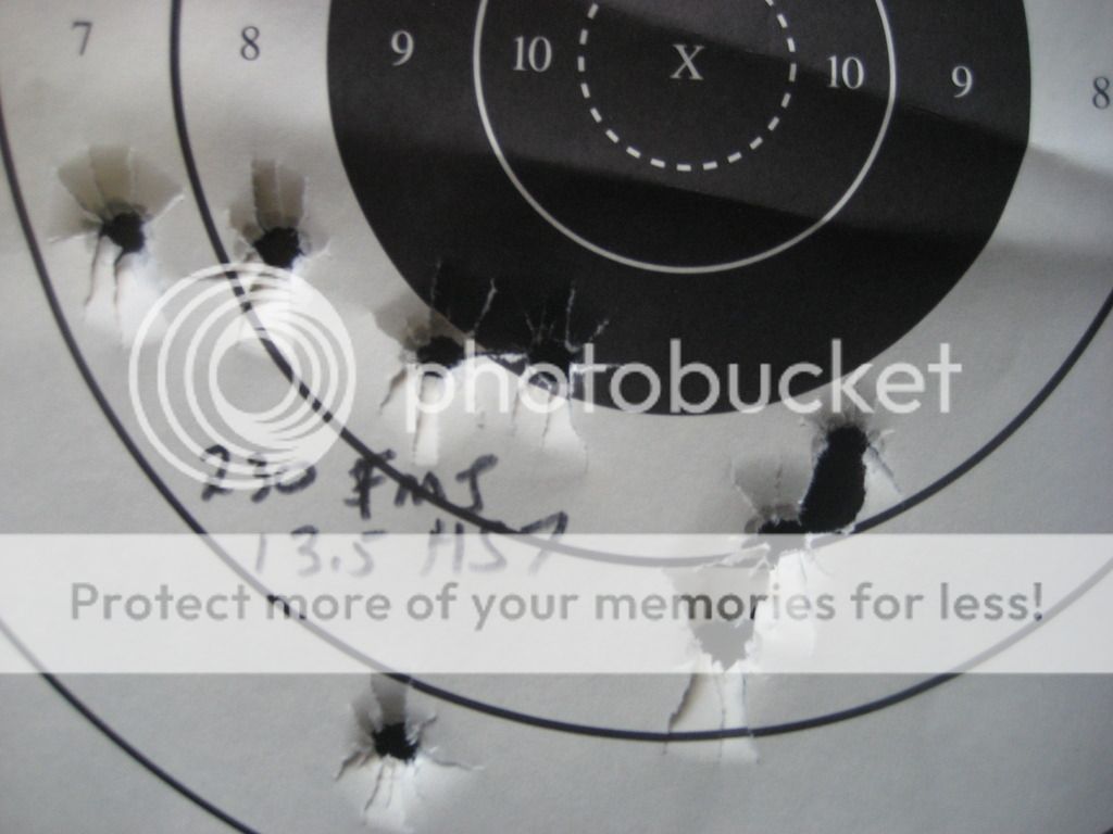

I loaded 50 rounds of 230 FMJ with 13.5 gr of HS-7 as a potential plinker round. (Lots of power (about 1200 fps), cheap bullet, powder I have no other use for).
20 yards 2 hands

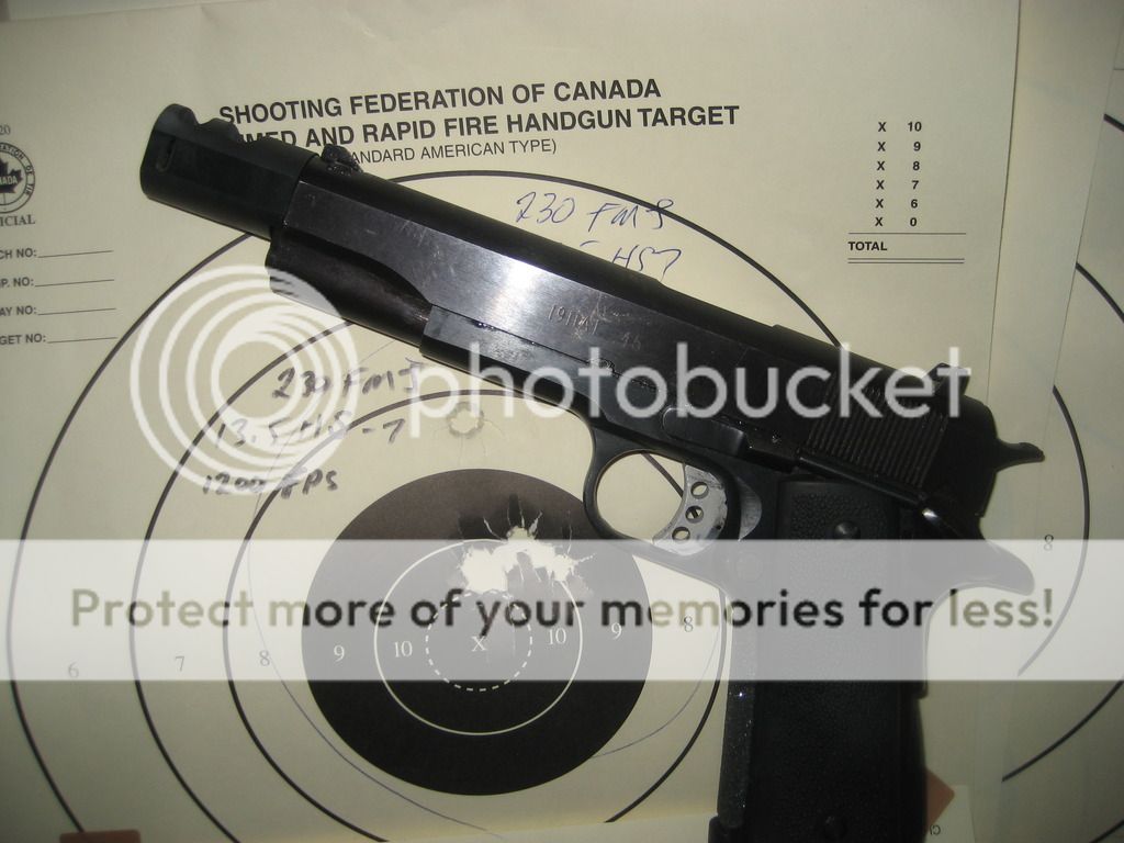

I have a handful of Norinco 1911 rear sights. They come in two heights. This was shot with the tall sight. Will knock it out and try a low one.
I have several of these 'no name" Norcs. This was the worst shooting one. Obviously all it needed was a new barrel and bushing. The pistol runs perfectly, including with full power 45ACP ammo.
My only complaint is I get a little bit of hammer bite with it. Nothing serious.
Nothing wrong with that load! With over 500 loads to a pound, that's a lot of dead targets (and a sore wrist).
that's the worst shooting one? Very impressive.
That was the worst shooting one in 45ACP. I was hoping that a new barrel and bushing would make it a better shooter. It did. The nice thing about the Rowland conversion is that if it shot poorly in this pistol, all I had to do is swap the barrels around and try another pistol.
But this way I found a good use for a 45 that shot poorly.
PS> Tonight I filed the rear sight down about 2mm and deepened the notch. That should move the group into the bull with a 6 o'clock hold, or maybe close to POA.

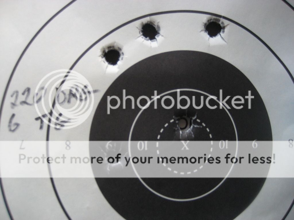

My heavy plinker load (230 FMJ & 13.5gr HS7) was shooting a bit high, and my light plinker loads were about 5 inches high.
The rear sight is a tall Norinco fixed sight. I filed it down by about 3mm and tried it again. I was afraid I was too aggressive, but it turned out OK.
The hot loads now shoot to POA, and the softer loads shoot about 4" high. I am pleased.
