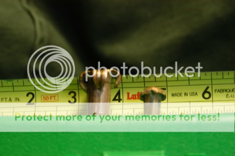

While loosing petals is a common occurance with the X bullet family, here's why I consider it a failure. Anytime a bullet looses mass, that results in a loss of momentum and a loss of momentum results in less penetration. If the shot is a broadside shot, that is of no significance, the animal is dead. But if the shot is quartering away or from dead astern, then it matters. Now comparing that performance to the performance of a good solid does not measure up. The solid has enough mass and velocity to penetrate a buffalo full length, and it doesn't matter if the bullet weighs 300 grs, 286 grs, or 270 grs. When loaded to the same pressure, provided the structure and profile are the same, all of those bullets will exibit very similar depths of penetration, although the shortest bullet has the greatest potential for straight line penetration. An X bullet that is loaded to it's velocity potential for weight, but looses 30% of it's mass cannot penetrate to the depth that would of been realized with the bullet in tact. My rifle is a .375 Ultra with a 20" barrel, so velocities are consistant with the .375 H&H.
A 270 gr and 300 gr X with the 380 gr Rhino
The 270 gr X with the 570 gr X
