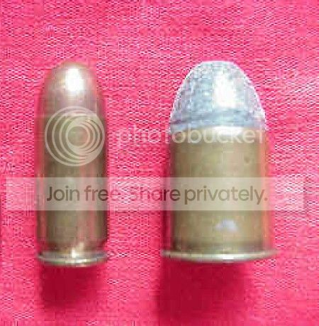

Any possibility it could be the pistol rnd
Here is the much shorter .577 revolver cartridge alongside a .45ACP round for comparison:
