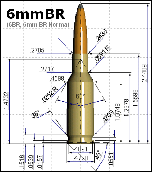

Actually, it (The 6mmBR Norma) was "designed" for European 300M ISSF competition as a *slightly* longer version the 6mmBR Remington.

actually ian, the 6mmbr remington(1.56) is the longer version of the 6mmbr(1.52)!

Bzzzzz! wrong. look again. You have it backwards... I know, I have trimmed enough 6BR cases to have the dimesions etched in my brain...
Ref: http://www.6mmbr.com/6BRFAQ.html#26585
What is the Correct OAL for the Case? New Lapua brass measures 1.556-1.557". SAAMI spec for the 6mm BR Norma case is 1.560". By contrast the OAL spec for 6mm BR Remington is 1.520". The Lapua brass is headstamped 6mm BR Norma-Lapua. We trim all our cases to 1.555" when any one reaches 1.560" or longer
ian, wrong again yourself! lol. when remington standarized the 6mmbr rem they made their brass 1.56oal on paper, but i have been shooting the 6mmbr along time as well and have measured my remington brass ant the cases are 1.55 oal! lol!! now check your e-mail i sent you an order!!!!
