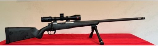

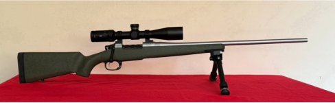

I have 3 rifles chambered in this Cartridge,
Two hunting rigs and a target rifle which I’m waiting for a stock for.
The 25” carbon fiber barreled rifle shoots the 175gr Berger Elite Hunter very consistently at 2900fps overtop of N555
ADG already makes head stamped ready to load brass for it and necking up Lapua 6.5 PRC brass is an easy option as well, I use a Cortina body mandrel.
This cartridge has quickly become one of my favourites.
