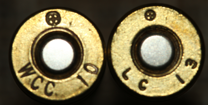

I buy once fired Lake City 5.56 and 7.62 brass because the brass is harder and has a thicker flash hole web. This adds strength to the base of the case and makes the primer pockets last longer.
Below is a cutaway of Federal and Lake City cases, the Federal cases are made of softer brass and have a thinner flash hole web. I had some factory loaded Federal 5.56 cases head stamped 09 and 10 that had oversized primer pockets after the first firing.
To sort the thinner and weaker cases a two inch rod was used to measure the flash hole web thickness. The thinner cases were tossed in the scrap brass bucket because of the higher chance of scoring the bolt face.
The above images and information are from AR15.com and the reloading moderators postings.
To further test the Federal cases a simple Lee depriming tool was used, and if the primer moved with just finger pressure the case was scrapped.
Bottom line, Federal marked cases are not the same quality as Lake City in my opinion, "BUT" some say the Federal cases have improved. I buy real Lake City cases and do not reload Federal cases from past experience and the work involved sorting cases.
