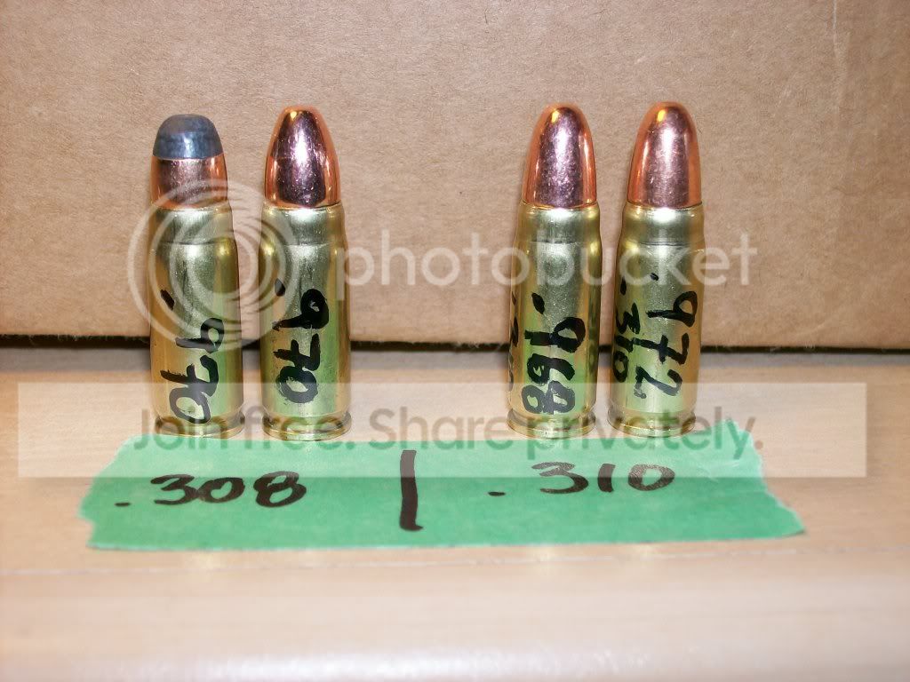

update
On Henry N's suggestion I tried some of his cut .223 blanks in my Tokarev pistol WITHOUT drilling the case to thin the necks out. Made 4 dummy rounds up (no powder or primer) and after crimping they all fed fine, in MY pistol. Labelled sizes are case length after forming- all required no trimming, only a chamfer inside and outside of the case neck.
Case overall lengths are:
.308 ( 1.310 + 1.351 )
.310 ( 1.363 + 1.373 )
I found that after forming, the .223 cases stretched about 7-8 thou, and
after crimping the overall length changed a bit too, a few thou shorter or
longer depending on what bullet I used. May have to mess around with the crimp a bit.
