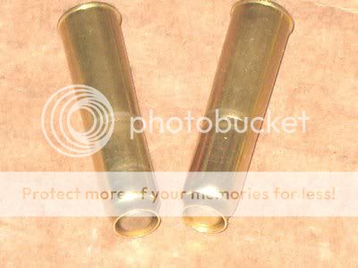

MY LOADING INFO
Alright, Heres what I did to make ammo for this revolver,
You Will Need The Following
Dremel/ Or similar air tool
Bench grinder
Lee 7.62x38 Dies(Actually 32-20)
7.62x38 brass
Small pistol primer
Bullseye Pistol Powder(or whatever you prefer)

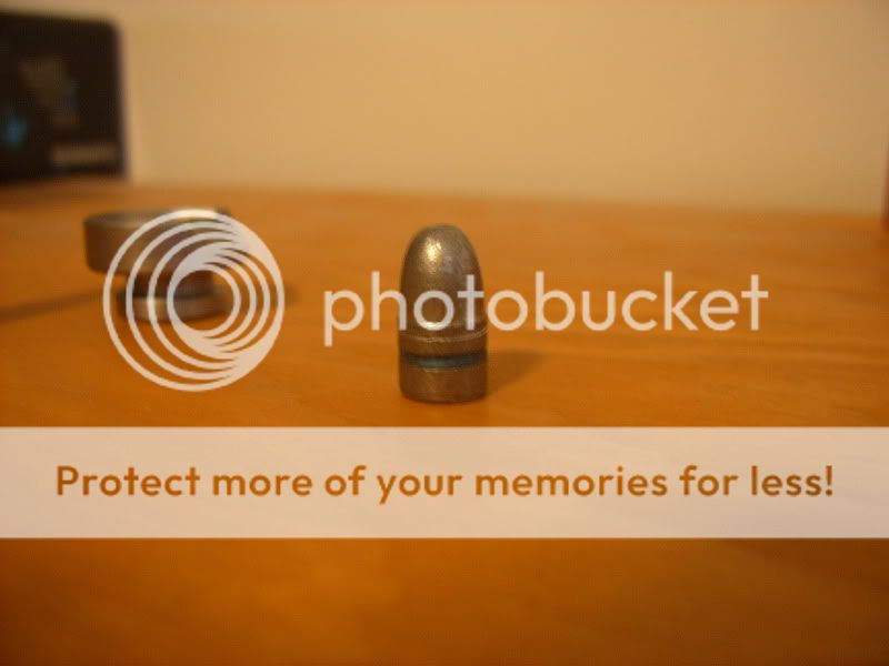

.32 caliber bullets.
Step#1.
First off I had to do some slight work to the shell holder in order for the brass to fit(This was more tricky than the other steps in the process) I used a dremel with a small grinding bit until I achieved the perfect fit.

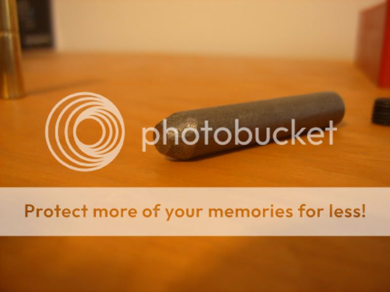

Step#2.

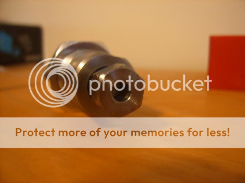

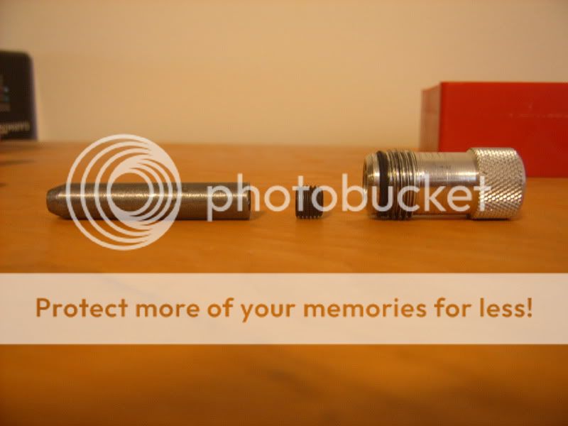

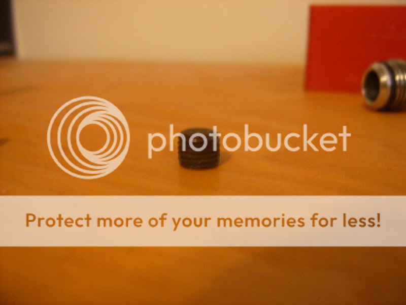

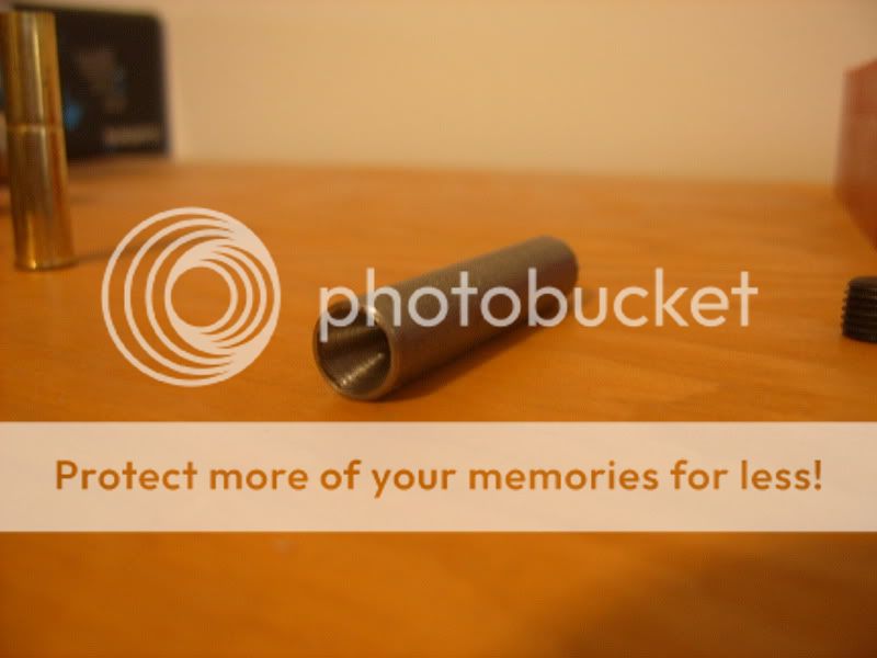

I needed a way to seat the bullet completely inside the case, The original seater would just stop at the top of the case rim and not seat the bullet completely level or inside, I took apart the seating die, Flipped the seating pin around and used a grinder to make a cone shaped bevel on the pin. The only problem I encountered was I had to clean the excess lead left by my bullets out of the die with a small flat head screwdriver, I was using 100gr RN bullets and seating them in upsidedown.
Now the pin sits slightly below the collar in the die and a spacer is needed at the top in order to keep it tight. I justed used what I could find in the garage, And it turned out to be a Hex plug. As for seating depth I manipulated how far I threaded the die into the press, I didnt have the shell holder touching the bottom of the die or anywhere close for that matter.

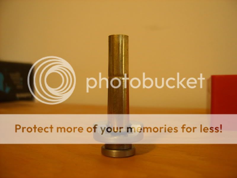

The Sizing/Decapping die does not have a long enough pin to deprime the brass properly and resize it, Since they cartrides are low pressure there isnt a need to do a full length size, I moved the pin half way down the collar so it only resizes the top half of the brass and deprimes it. The press handle just comes to a stop.
After shooting my brand new loads the once fired brass fell free from the revolver without any issues.

.32 caliber 100gr lead RN bullets

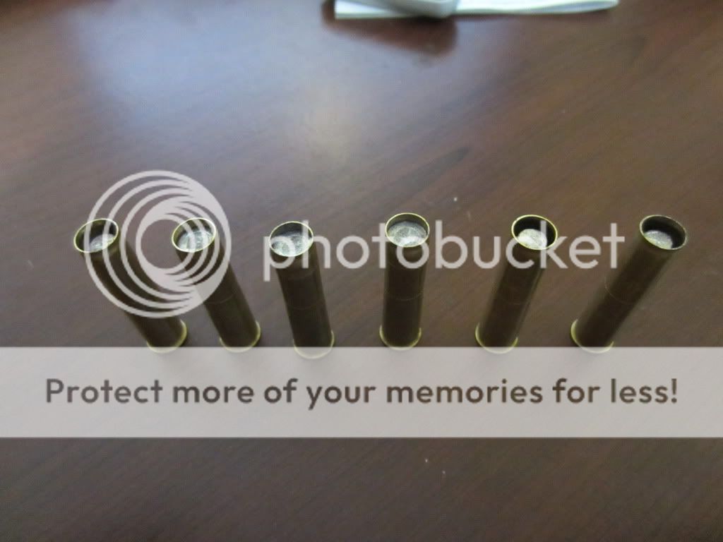

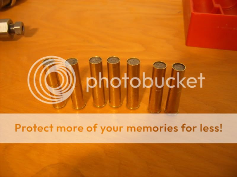

My loads ended up looking like this. Some people may need to put a crimp on their brass in order for it to work in their revolver, Mine works fine without it.
UPDATE #1
Well I encountered a problem, too much lead was being scraped off the bullets, And they werent grabbing the rifling in the barrel and were tumbling, So I had to expand the case mouth, I expanded too far for the first few cases and when I seated and crimped the bullet I couldnt get the round into the chamber.
My solution
I expanded the case mouth but not very much, maybe a cm or two, just enough the bullet would sit in the case mouth. I did this by only threading the expander die a little ways into the press. I tryed seating some bullets the proper way up but still ran into some lead scraping, So I continued to seat the bullets upside down, Doing it this way not much lead is scraped off the bullet. With jacketed bullets you could seat the bullet either way you want, I'll post some pictures after I charge my camera

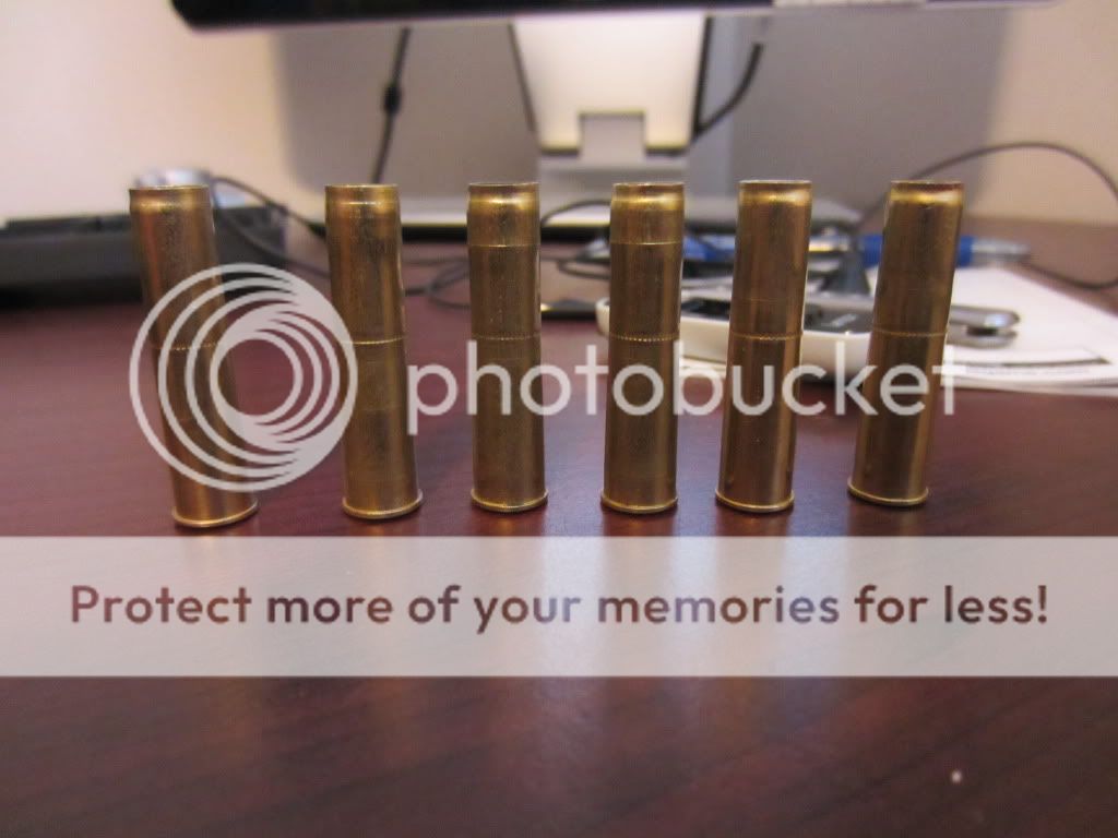

UPDATE #2
Another Issue I've run into was that after I had expanded the case mouth and seated the bullet, The crimping die was not enough to remove all bell from the case mouth and my rounds would not chamber in the cylinder. So what I then did was removed the decapping pin from the resizing die and ran my finished rounds through the resizing die about 1/4 way down the brass. My finished loads now look like this, You will Notice I faced some bullets right side up and some upside down.
