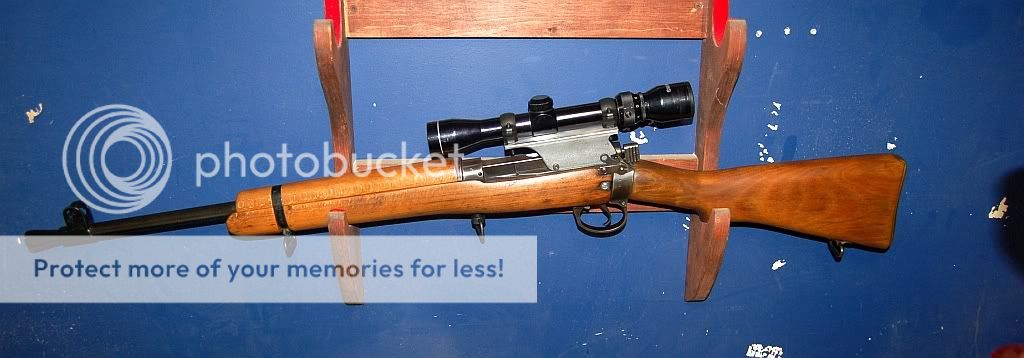

As a follow up to my previous post... http://www.canadiangunnutz.com/forum/showthread.php?t=445217&highlight=enfield ... I figured I'd give an update of my Enfield conversion now that it wears a scope:
I made up a 303british.com "indestructible scope mount" style mount for my little pet and held it in place with a screw into the ejector hole (unneeded with the bolt head mods) and a screw through the rear sight base. So far it is rock solid with only two piddly little hex screws holding the chunky 3/16" angle iron base in place. I popped on a cheap vintage 2-7x32 Tasco scope that was given to me by a buddy and took her to the range.
