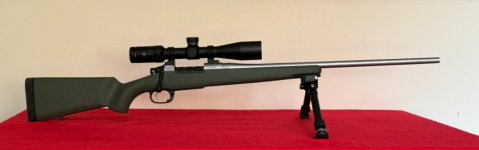

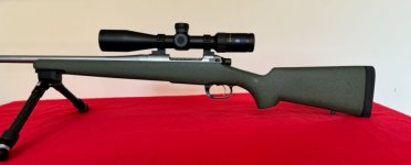

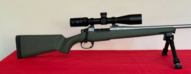

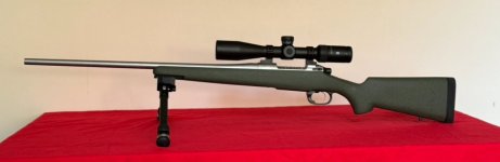

Here’s my latest build, it’s another 7-6.5 PRCW
Built by Mitch Kendall, I can’t thank him enough for his attention to detail,
Defiance AnTi XM action and Defiance BDL Style Bottom Metal,
Triggertech Special Trigger
23 inch 1-9 twist #2 contour Benchmark SS Barrel
Wildcat CF stock, 13.5” LOP
Mitch did a pile of alterations to the stock, using a Gunwerks Clymer as a pattern for the negative comb, flattened out the toe line, put a large dish for the base of my thumb which creates a natural palm swell, fitment of the stock to my hand is excellent and it shoulders like a dream, added a flush mount picatinny rail up forward.
Black Gunkote on the bottom metal, bolt release, bolt body and handle.
The rifle weighs 7 lbs 5.2oz scoped with Talley’s holding a Zeiss V4 4-16x44, about perfect for my deer hunting rig.IMG_4886.jpegIMG_4894.jpegIMG_4887.jpegIMG_4895.jpegIMG_4888.jpeg

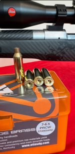

Your not wrong on any of your points, yes the 7mm PRC will outperform the 7-6.5, I was a total 280AI lover which in my mind is about as perfect a cartridge for hunting made,
Funny thing I was just going to build a 284 win hunting rig when the 7-6.5 PRCW showed up and has started to dominate the F-Class world, holds a couple more grains of powder but better brass life as the primer pocket has more brass surrounding it, hardly worth noting for a hunting rifle of course.
I was wanting to build an F-class rifle chambered in the 7-6.5 PRCW but had to wait several months for parts so I thought I’ll build a hunting rifle and get a feel for the cartridge, it’s basically throated for a 180gr Berger, I chose the no turn neck reamer as I don’t turn necks on my brass.
So far it’s been nothing short of awesome, very accurate, extremely consistent using necked up 6.5 PRC Lapua brass, low recoil…. Much less than the 7mm PRC, I prefer not to use a brake on my hunting rifles.
So in the end I can use use one cartridge for my hunting rifle and my target rifles……makes perfect sense to me.
