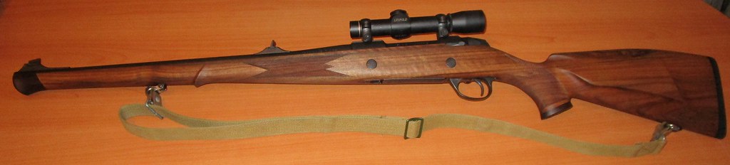

So as not to void the warranty on my new Sako Bavarian Carbine I'm going to first see if the 220gr factory loads will shoot with acceptable accuracy and if so give these a try on Moose. Or as an alternate, if my rifle will stabilize these, develop a load using the 240gr Woodleigh's. A muzzle speed of 2300 fps should be safely achievable from its 20" barrel.

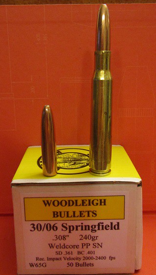

Those 240 grain woodleighs look pretty goofy. I am very curious about how they perform on game though. I exchanged some emails with the guys from woodleigh a while back and apparently they were designed for one rifle hunters to take down water buffalo.

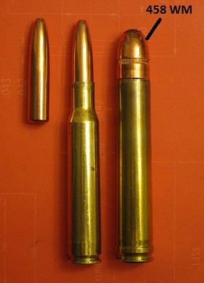

Those 240gr pills are pretty ridiculous looking. I'd love to see a side-by-side between a new one vs a recovered bullet.... Conor, do you know if the one rifle woodleigh designed the bullet around was the 3006 or the 300win mag?
I honestly can't remember if we broached that, but I do know it was suggested that the 240 and some solids could be used in the '06 for water buffalo, so I think they're perfectly fine at lower velocities.
I always thought a 220 grain rn in the 06 looked kind of ###y, maybe the 240 is too curvy for me, big girls need love too though. :p
My conversation with them was about using heavy .312 bullets in the 7.62x54r, and if their 300 grain .338's were intended for the .338 wm or 340 wby. They did suggest that the 300's were designed for buffalo in the 338 wm but could be used in the .338/06. I think their bullets, generally speaking, expand very well across a wide range of velocities even the heavies. They also seem to shoot very well in all the rifles I have tried them in.
As a fan (for no good reason I'll be honest) of heavier round nose bullets I like their line up. I've only shot a handful of big game animals in my short career as a hunter so who knows how that opinion will change in time.
In my experience if you email woodleigh they are happy to basically shoot the #### with you about their lineup and suggest loads for stuff they don't have published if that's what you need. They also extensively test their bullets on real game it seems judging by their responses.

Information on the 30 caliber 240gr Woodleigh: developed to commemorate the 100th anniversary of the 30-06 in 2006. Quite capable of taking Buffalo as is their 220gr FMJ they claim, and the 240gr is very effective on Camel. :eek:
I've loaded the 240gr in my 300 WM Sako Grey Wolf at about 2500 fps MV. Recommended twist rate for the 240gr is 1:10. The 300 WM and 30-06 Sako rifles have 1:11 twists. 5 shots at 100 meters off the bench with my 300 WM grouped about 2", not too bad. Barrel heat probably had an effect on widening the group.
The 240gr at 2300 fps MV from my 30-06 should be adequate to bust shoulder bone/sever spinal chord on Moose broadside at ranges of up to 75 feet. ;)
