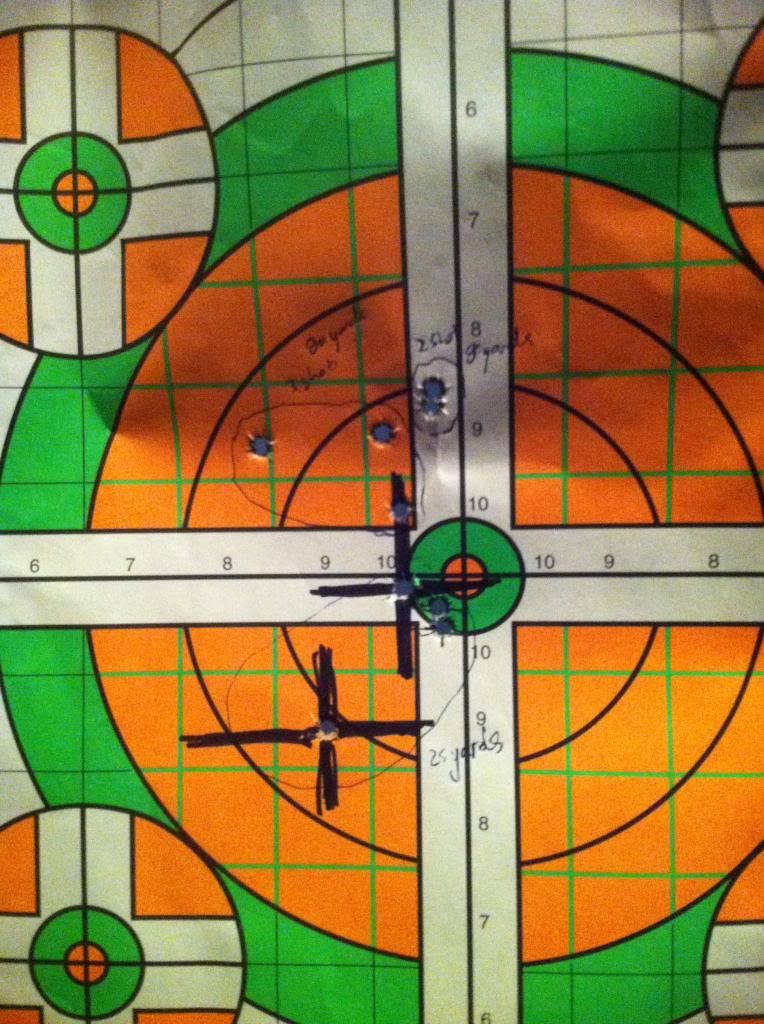

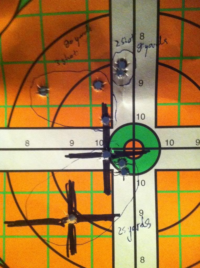

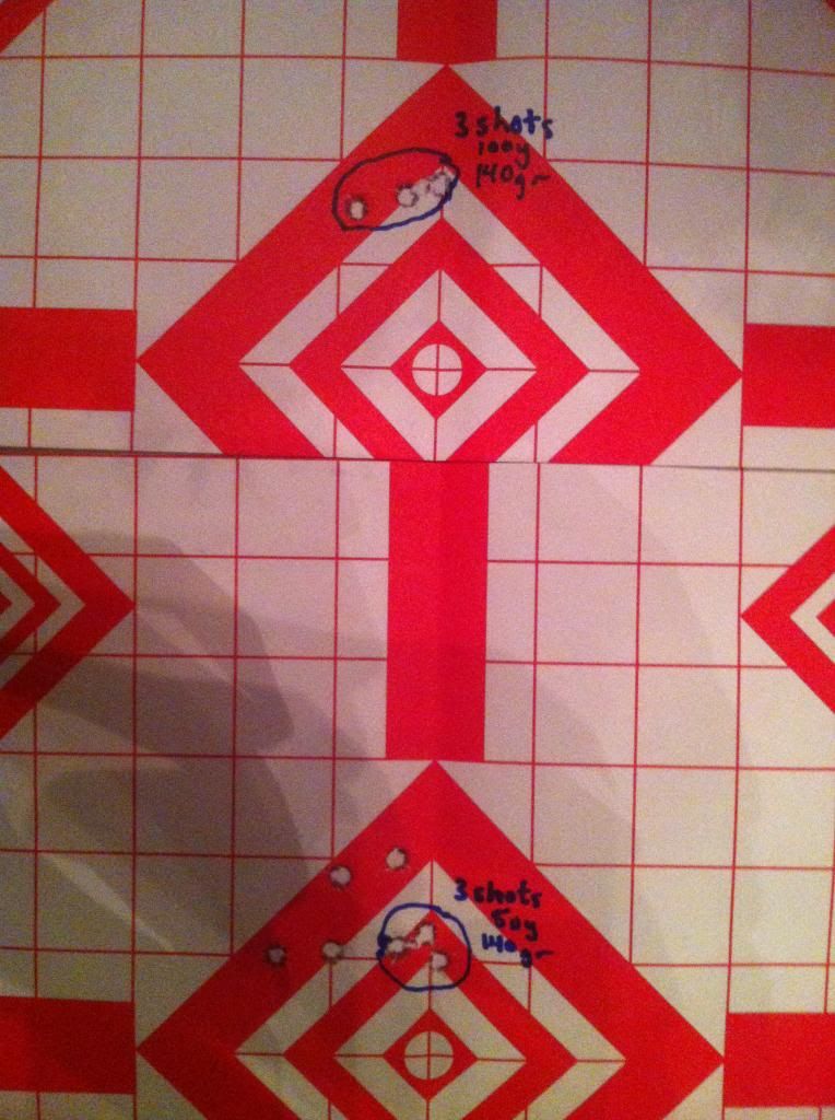

I'm getting decent results with the 140 gr S&B that I was using. I need to stop into Epps this week and see what they have around for 7x57. It would be easier if I could hand load, but honestly, it seems like a large investment for one gun.

If you're having accuracy issues with that Santa Barbara, it likely needs to be glass bedded and the barrel free floated.
Also, when was the last time the copper fouling was cleaned out of the bore?????

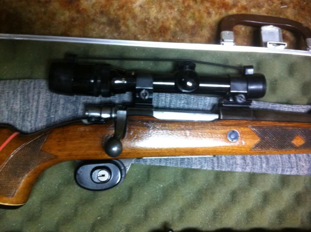

That scope mounting job sounds a bit mickey mouse at best. Is everything tight???? Is it all level???
That rifle, is worth cleaning up the stock on and bedding it properly. It may never be a tack driver but it will definitely keep its point of impact within 2 minutes of angle at 100+ meters.
