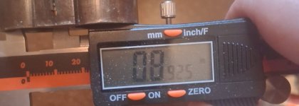

UPDATE TO MY 8 BORE PINFIRE it isn't really an 8 bore it is something larger. I finally got some 8 bore cases to see how the fit is and if I had to modify the cases heavily and they don't fit almost fall straight through, the brass 4 bore case i got fits pretty nicely but length and i only have 2 to mess around with so not an option. I did finally get my digital calipers to do some measuring and it is close to a 7 to 6 bore gun. I will have to figure out what calibre this is one of these days but I now know it isn't a standard 8 Bore.
