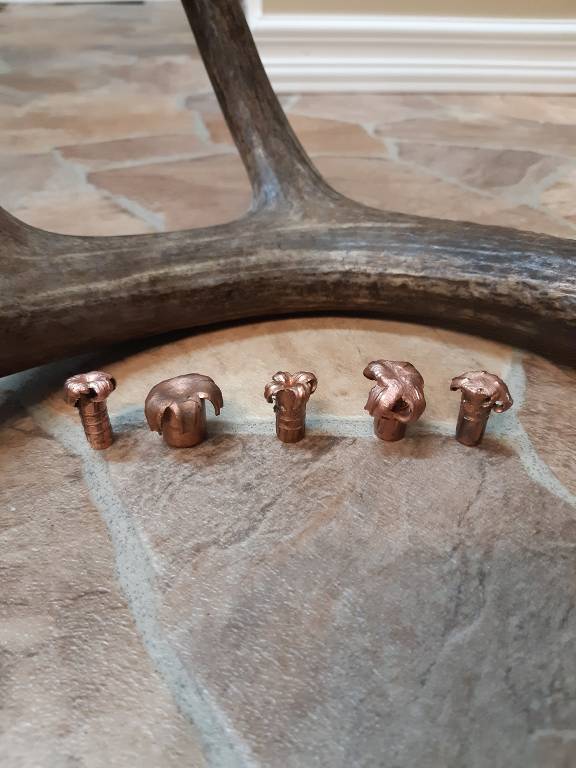

Just some recovered TSX/TTSX for the fun of it. Of all the game I've shot with them I've recovered just 5 bullets. Always excellent blood trails, wound channels and outstanding penetration. Never had anything run off an excessive distance. I'm always surprised when I don't see an exit wound, it doesn't happen often for me.
Here's a recovered bullet from last year out of the 8x57. 180gr tsx 2780fps. Shot distance 180 yards.
100 percent weight retention.
