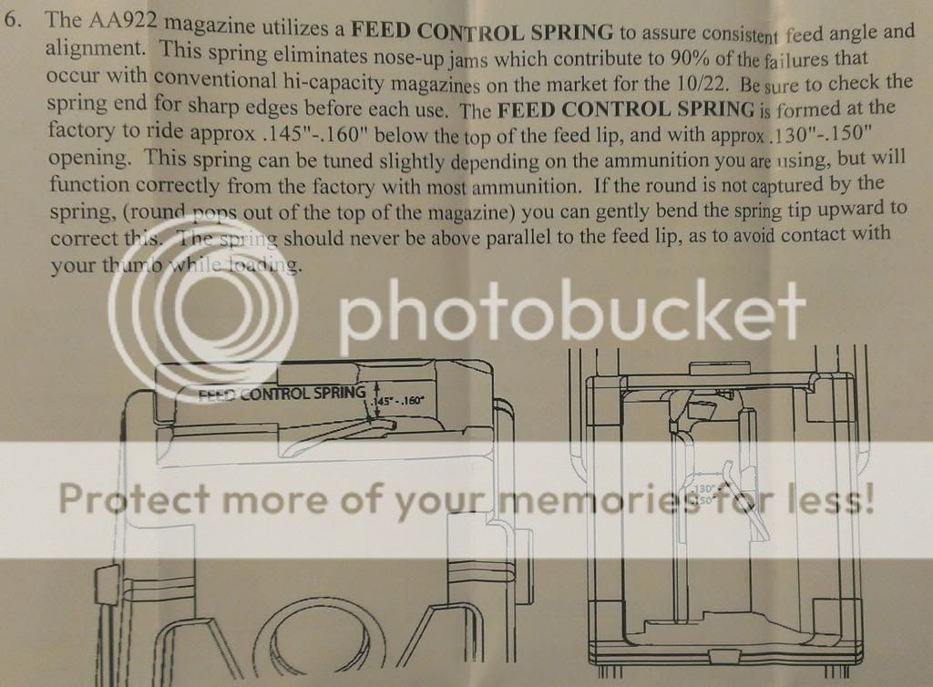

What did you guys set your feed wire to? I don't like the way it is indicated on the instructions.
I'm about 75% sure I threw them out, I'll check tonight.. It had an explanation as to how to set the wire/feed thing. Wasn't a great explanation but it was there.
Here you go:
Mine came with instructions now how do we sort out if they are 2's or 3's .Tetra said his came in factory packaging and mine came in plastic bag
mine had instructions in a plastic bag but they say aa922-a2.... I know aa922-a1 are gen 1 and aa922-a2 are gen 2. Shouldn't gen 3 be aa922-a3?
