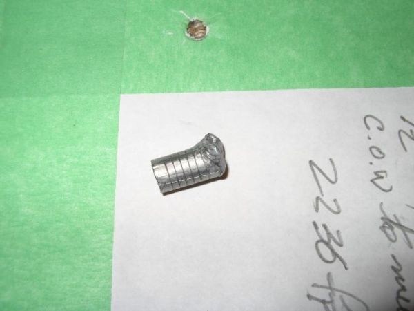

One of the great things about the 9.3X62 is that it works with just about any bullet you put into it, even cast 285s work. This one at 2200+ went through six jugs, and was caught in the seventh.
