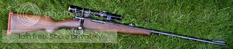

You probably meant an extra 150 FPS, and it would be crazy in this "little" angel.
A svelte 7 1/2 pounds as you see it.

Dirty old typos. Yes, 150 is correct.
This one is 7 pounds 11 ounces with a sling and belly full of ammo. I don't want Andy's 2610 FPS loads either. My 286 RNs at 2350 killed a bison...that's good enough for me at this point.
Every time I see that rifle, I want to clone it BUM, except for the length of pull. That is about as classic as it gets. All the stock needs is side panels alongside the action, and it could have come out of the very early 1900s.
IIRC, your dad made the rear sight, right?
Thanks for showing it again.
Ted
Your memory serves quite well. Dad made the rear sight and pitted the front sight to the barrel. That took some doing.
