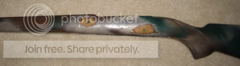

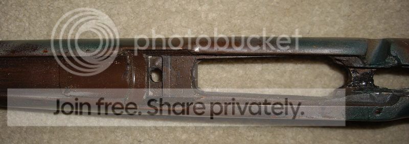

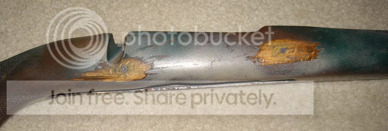

Well the 55 gr of IMR4895 load was very accurate, and also very hard on the stock of "The Ugly 9.3" rifle.
So much so that it is getting a complete refit: Marine-Tex bedding,
and two cross bolts.
This old workhorse has done more than its share of work. After travelling thousands of miles in trucks, boats, and float planes, she deserves a decent retirement. Getting a new paint job, then it is heading to The Rock to grace a nice little 6.5X55 hunting moose, caribou, and bear. :)

Use Federal 30-06 exclusively in one rifle, and it takes loads as hot as Norma without a whimper. This was the stuff that split the stock on "The Ugly 9.3"
Ted
