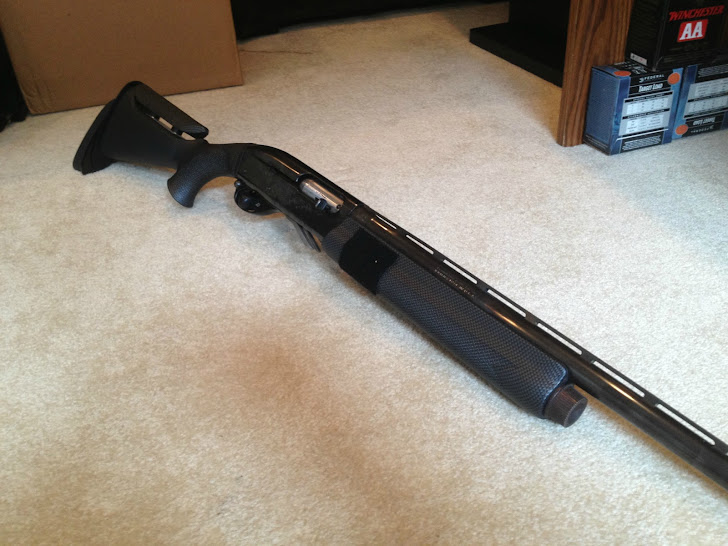

Here is my Remington 1100.
The gear permanently installed on the stock; Dave's Metal Work Eazyloader, Jack West Carbon Fibre Youth Stock (13" LOP), sling mount, adjustable recoil slider and enlarged safety.
All I need to do to finish it is sand the adjustable pad slider to fit the stock properly and add a high vis follower, but it's usable at this point.

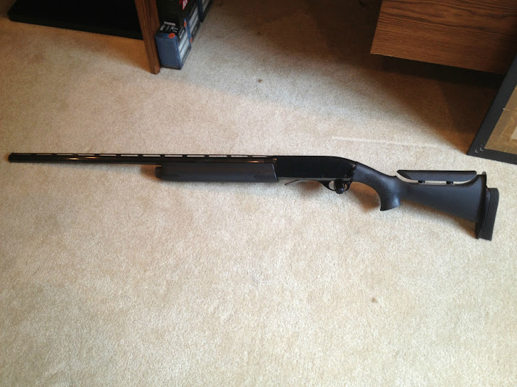

I use this gun for sporting clays with the 28" barrel (removable chokes) and removal of all the shell carriers.

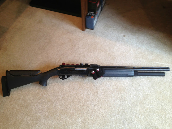

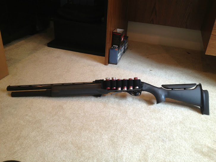

And for the tactical/IPSC style built besides finishing the stock, all I need is a mini red dot (I think a burris fast fire 3 for Christmas). It has 20.5" barrel (removable chokes to be added), shell carriers, a 3 round extension (plugged/pinned at 5) and heavy duty cocking handle.
Not too bad for my first build, and it works very well in pretty much any arena.
