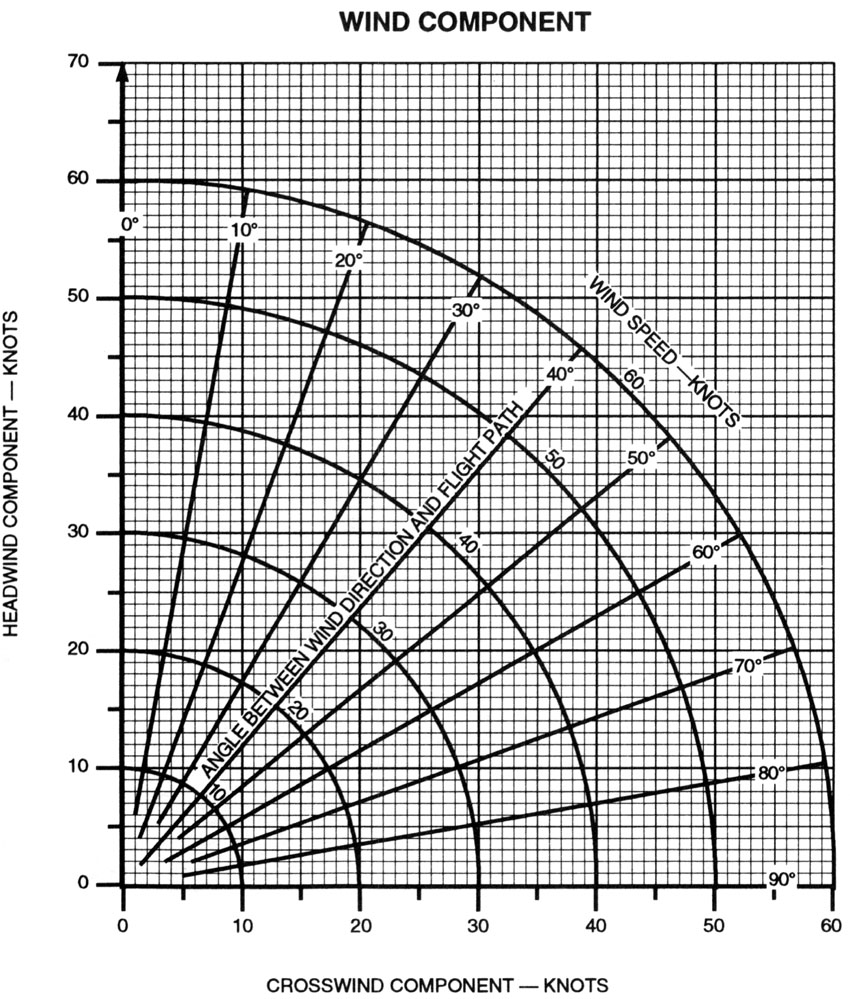

Also, a full value wind is sometimes better than a half value wind (imo) because both wind speed and direction change constantly. A wind direction change from 0 o'clock to 1 o'clock is a 50% change in windage adjustment value (0% to 50%). A wind direction change from 2 o'clock to 3 o'clock is only a 13% change in windage adjustment value (87% to 100%).
EDIT: Short answer: If the wind direciton is changing alot: full value wind is a good thing
If the wind speed is changing alot (gusting): headwind/tailwind is a good thing.
