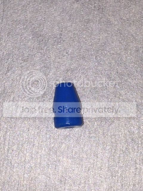

Ok, I have a NP-29 and I am casting 125 gr TC bullets for it. I am using range scrap and powder coating before sizing. I do not know the BH of this lead. I have slugged the barrel and it came out at .3555 - .356. I sized my PC bullets to .358 and loaded them with 3.4 gr of Bullseye. Accuracy was crap and light leading present. I figured to large of bullet. I then sized to .357 and loaded Bullseye at 3.4, 3.6, 3.8, 4.0, 4.2 and 4.4. Light leading still present. Accuracy at it best with 4.0gr but I know it can be better as I have shot tighter groups with Berry's bullets with 4.3gr of BE. I have some WW lead I am going to try next. Do you think this is a lead hardness issue or am I missing something?

can you take some pics of the bullet and the leading.

The projectiles should be sized at .356 after powder coat.....
I suspect that is the problem....
And I'm not sure if it's leading..... There shouldn't be any leading if powder coated properly.
The lead hardness won't matter a whit if powder coating. The little I've played with it I've noticed that when you heat the projectile up to powder coat it doesn't matter what the bullet started at, it always comes out at BN of 11/12....

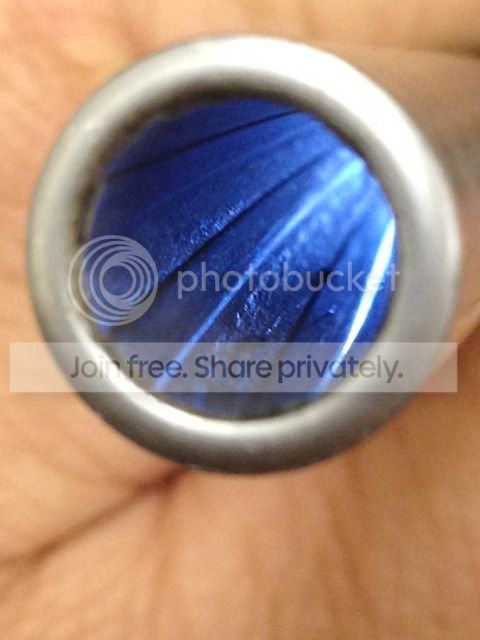

When I clean the barrel, it is streaked in the grooves. Requires some scrubbing to get it all out. I will see if I can get a picture of the barrel.
Is it anything like this.
Pop a few into some H20 and have a look.

Peroxide and vinagre will strip leading easy by the way.
