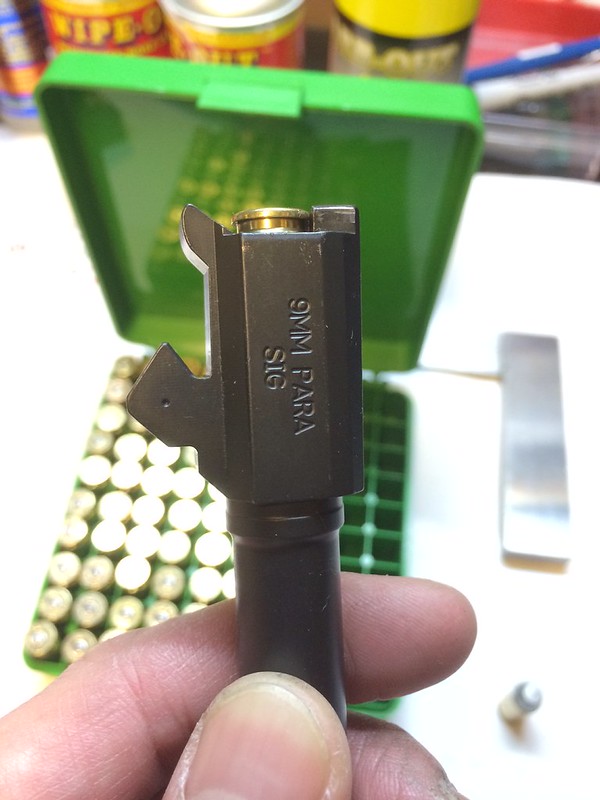

Here's where I need some help. These feed reliably in my Beretta 92FS and Sig226 barrels easily. I did the drop test in each barrel to see if the ammo would fall out easily and they do. They headspace perfectly.
Now when I try this test on my Glock's LoneWolf barrel, the bullet hits the lands and does not allow the entire ammo to sit safely in the breech. Sorry, forgot to take a pic.
The only way to get the ammo to sit in the LoneWolf barrel is to seat the bullets down to 1.005". I'm guessing the OGIVE on the RNFP is longer than your regular RN.

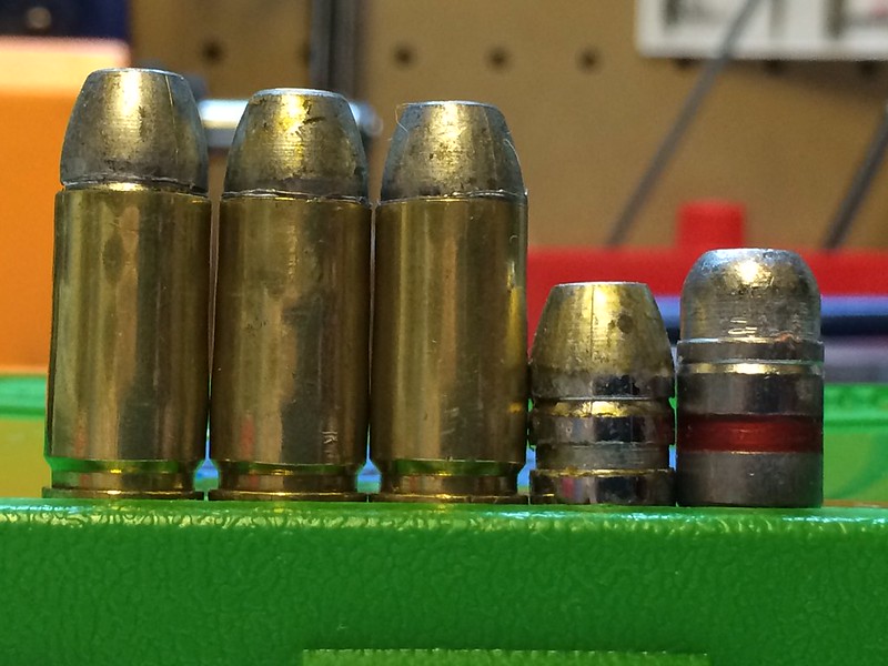

Here's an overall pic of the ammo/pills.
Left to right - 1.055", 1.010", 1.005", 132gr RNFP, DRG 158gr RNFP for my 357Mag.

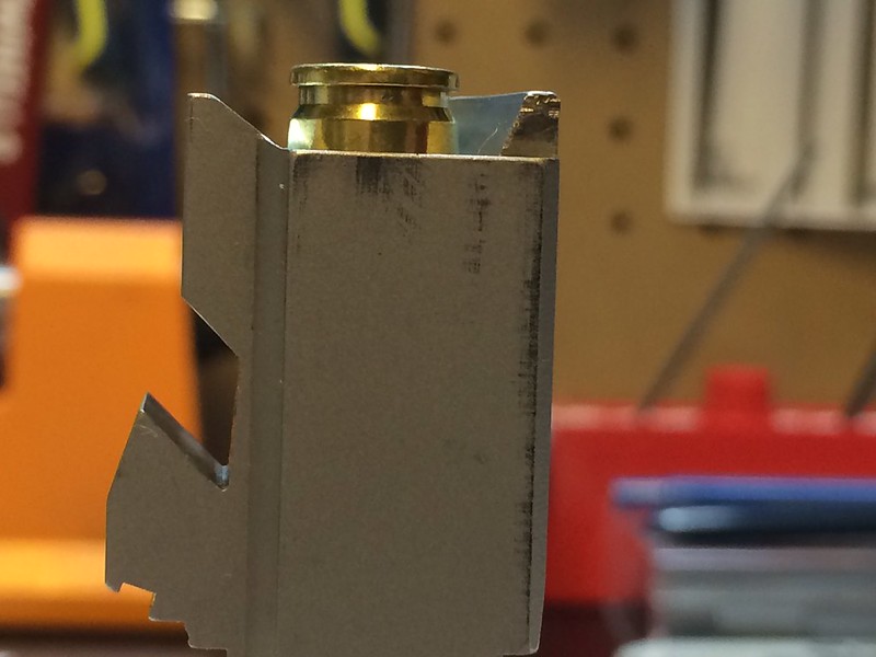

Here's the 1.055" ammo seated in my LoneWolf barrel. Same ammo fitted in my Sig226 above.

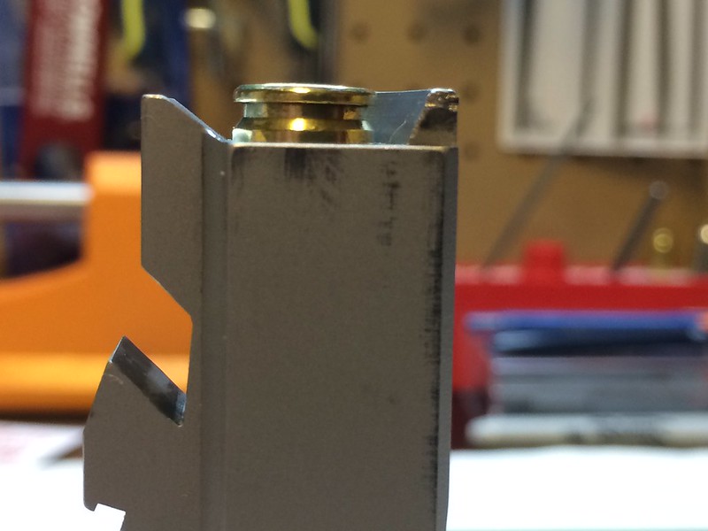

Here's 1.010" in the LoneWolf barrel. It is JUST making contact with the lands.

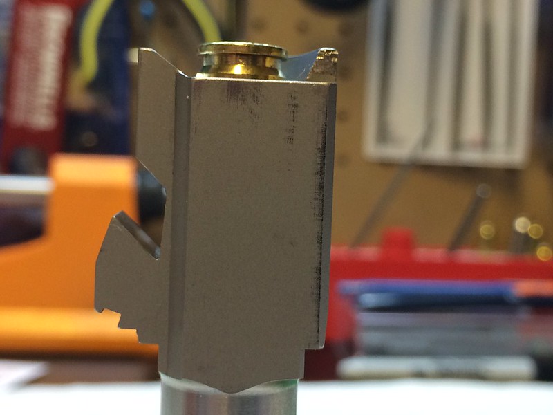

Here's 1.005" in the LoneWolf barrel. It falls out cleanly.

Maybe it's the photo but the cartridges in the centre and on the right (1.010" and 1.005" seem to have some lead shaving going on. You might want to to try expanding the case mouths a bit more.
