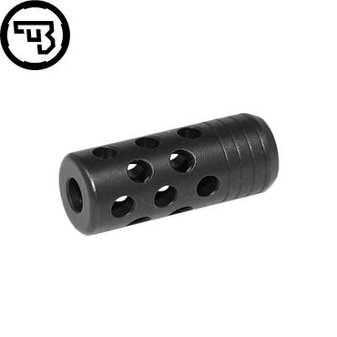

The muzzle compensator is there for looks only. If it improved accuracy performance at long distances, it would also improve accuracy at shorter ranges. No one should think a compensator is designed to advance accuracy.

But that's not the issue here. If sticking a random weight like a compensator on the end of a barrel actually improved performance, they would be used as a matter of course. And clearly they are not.
Shooters shouldn't expect an arbitrary weight screwed on a muzzle to improve accuracy performance at short or long range. It may by lottery-winning random chance improve performance, but it's more likely to be neutral or possibly degrade performance.
A compensator shouldn't be confused with an adjustable tuner, which doesn't work simply because it's on a muzzle. A tuner is a weight that can be moved in tiny increments beyond the end of the barrel's muzzle. It has to be carefully adjusted to achieve the best weight past the muzzle -- and they only work to improve the performance of ammo that's already performing very well.
For a compensator to function as a properly set tuner, it would need to be exactly the right weight at the right distance beyond the muzzle. Neither compensators nor tuners are a shortcut solution to improve accuracy. And it's worth noting that tuners aren't generally expected to be effective on a relatively short 20" barrel such as that on the CZ 457 LRP.

A compensator or brake such as that on the CZ 457 is 1/2 X 20 UNF and has 20 threads per inch. If 1/2" of the muzzle is threaded, ten revolutions removes the muzzle device altogether. (The CZ compensator or brake is shown below.)
