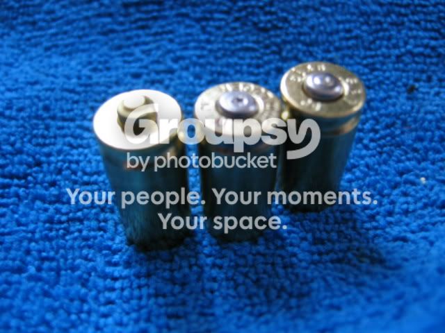

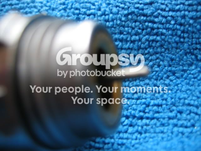

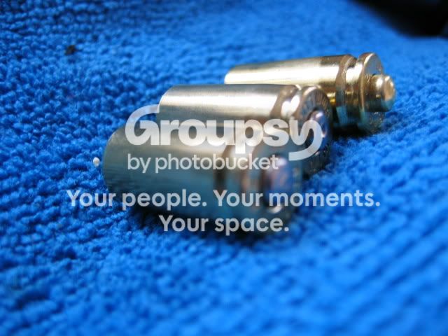

My Hornady LnL started misbehaving over the last couple of reloading sessions. About 30% of the time, the decapping stem fails to push the spent primer out. The spent primer stays in the flash hole, just barely holding onto the case. Sometimes I can make it loose by jiggling the shellplate - other times I have to remove the shellplate. When stuck, the shellplate won't index. This slows me down tremendously.
When removed, the spent primer has a visible dent where the stem was pushing into it. The jam happens mostly with CCI primers, but occasional Winchester ones give me trouble, too. I moved the stem down as much as possible, way more than the recommended 1/8" but still no dice.
Any help is appreciated. TIA.
