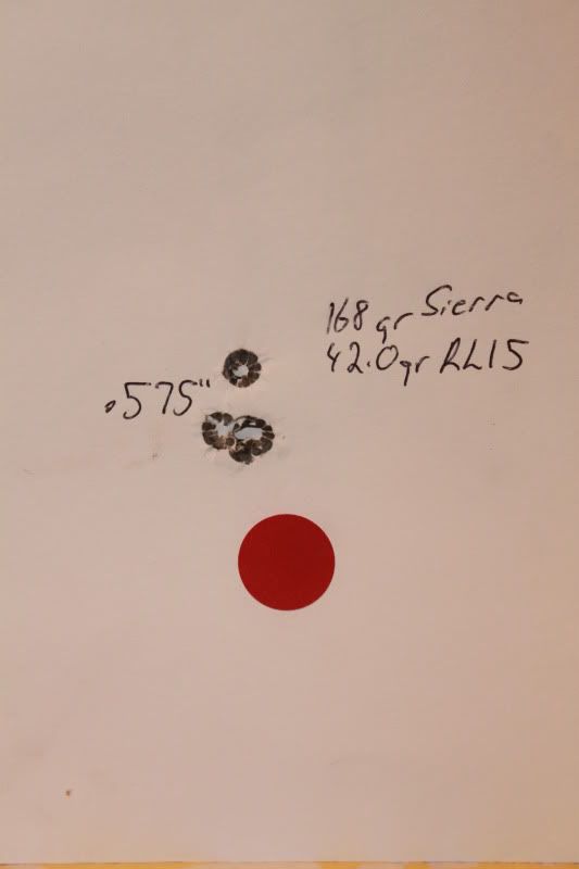

Here is the VERY FIRST group I shot.
This is a load that i had worked up from another 308 i used to own. (shows potential)
And another from the same load
BUT!!! Here is the group of the day 5 SHOTS AT 100 Yards
