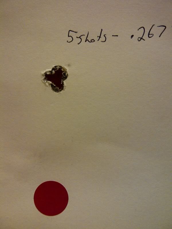

That's what I was thinking about 10 shots in.Looks like your load is comming together nicely. Your ladder test would have been a bit easier to decipher if you had shot them on 2 different pages.
Lots of money to just shoot 1/2"?
Will it hold the 1/2" @ 500? or 800?

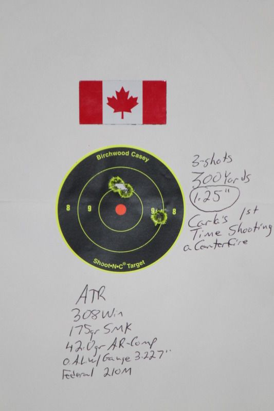

I finally talked my wife of 17 years into shooting a gun. My son took her out one day and she shot his 22. She only took 9 shots out of his gun. So today I sweet talked her into shooting my Alberta Tactical. We set her up on the bench, and dialed the scope to my 300 yard zero. This is her only 3 shots, and only the 10,11,and12th shots she has ever shot. I am VERY impressed. I just asked her if she will ever shoot it again, and she just shrugged her shoulders and said, "I just dont get the same thrill out of it that you do." I hope she will in the future because she was good.
