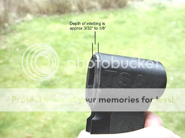

Now here is where the Chu wood stock comes in handy. Use it for practice before cutting up that USGI fiberglass stock you worked so hard to procure. Take that empty Chinese stock, put the trigger assembly in and line up the adaptor (pistol grip mounted) where you think it should be and at the angle you want. Scribe a line and then scribe another line about 1/16” back and cut along the second line. Remember it is better to cut off too little than too much. Now you can experiment with getting the angle just right and how close to the trigger assembly you want the grip to be. Keep in mind though that you want some good material left at the back of the receiver and that if the grip is too close it will interfere with the opening of the trigger guard.
At this point you can move on to the good stock or continue with Chairman Mao and practice inletting. The first time I did this I chose the latter cause I figured I might mess up. I did but not too much and it gave me an idea on how best to proceed. No matter which stock you use here is what I do.

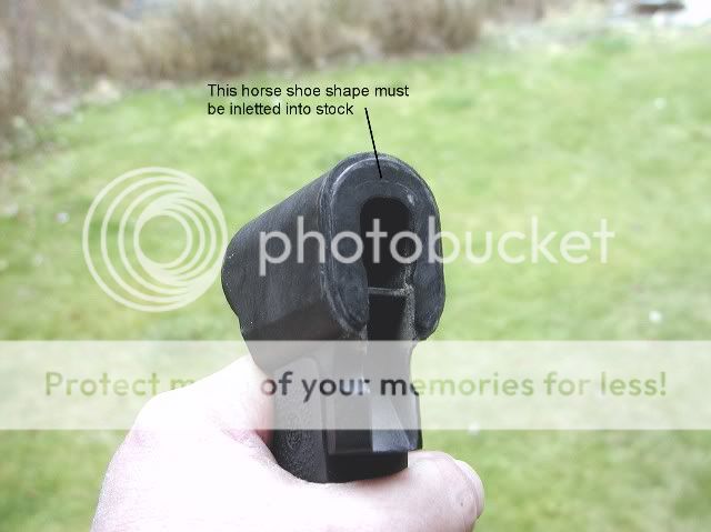

First you have to get an outline of the horse shoe shape on to the face of the area to be inletted. I tried Prussian Blue and lipstick and the grip just kept sliding all over the place giving me no readable outline. So I just sat at my desk stamping “PAID” on some accounts and voila. After cleaning the grip and face of the cut, I inked up the horse shoe, lined it up and pressed. Had my outline. Inletting with a dremel is self explanatory so I won’t go into detail. If you don’t have a dremel, small woodworking chisels would do the trick if you got’em. Just pay attention to the depth and outline and there shouldn’t be any problems.
