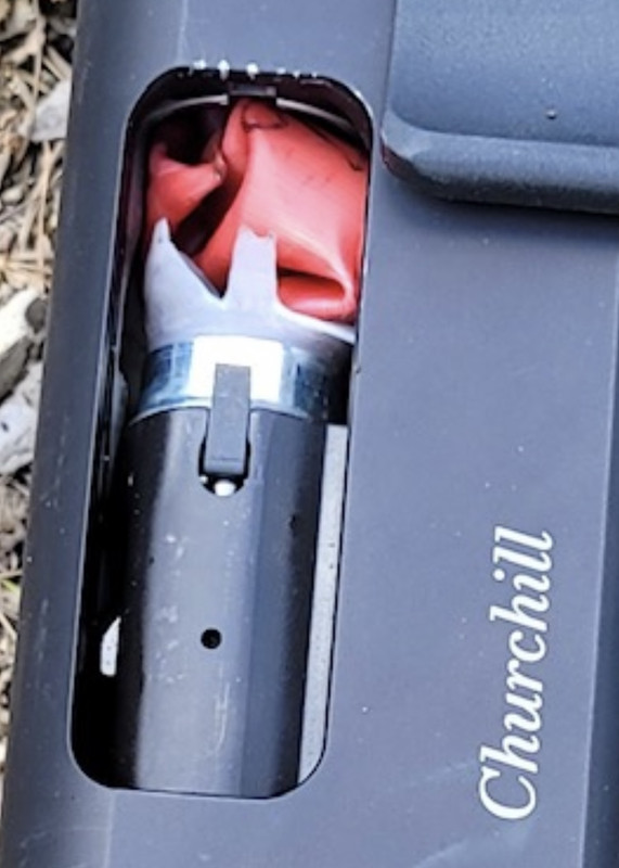

Shot cup would have left the barrel.
If it was an out of battery explosion, you’d see a whole lot of powder burns, a bulged shotshell head, way more damage to the gun and possibly some blood.
The white shell appears to be intentionally cut and there aren’t any powder burns on its cut edges. It all looks too pristine.
Newbie is messing with us.
Why are there two different colour hulls in there? The red one looks intentionally crumpled and jammed into the tube with the white one cut up behind it.
The hull beside the shotgun on the ground, what is that? What happened to its head? Looks to be cut clean off.
Is this a joke? Clown photo?
It is one hull blown apart! The white is the base wad of the shell ... not the shot cup ....

Doesn’t look like a base wad compared to your sectioned photo. Looks more like an intentionally cut hull to me.

No chance that firearm was purchased new. It looks to have been modified and clearly made unsafe. I doubt there will be any warranty on it. Likely cheaper to buy another than to try and fix that gun.
Bingo.
