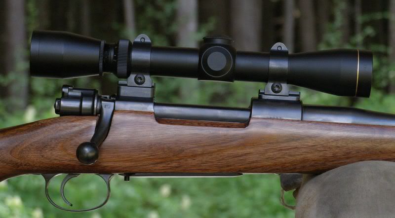

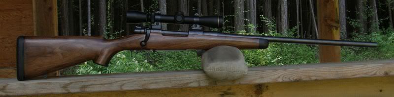

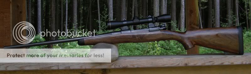

Some have been asking about the rifle Ted used on his family adventure. We had a nice chat on the phone the other evening and, among other things, this thread was discussed. I am only too pleased to describe the rifle.
Ted told me that the rifle has acquired some 'character' in it's travels. That is as it should be.
Ted's 9.3X62 Mauser is one I built on a JC Higgins(FN Mauser) action with a 21' Heym barrel. Other than lapping the locking lugs/seats and tapering the rear tang, nothing has been done to the action. The safety is factory and the trigger is a Timney Sportsman. Action/barrel work was done at Corlanes in Dawson Creek, BC. I did the metal polishing and slow rust bluing.
The stock is unique in that it a English Walnut laminate given to me by a Local gunsmith. It was configured as a target stock with a huge beaver-tail forend, roll-over cheekpiece and a very generous grip. It's total weigh was well over four pounds. After inletting and bedding, a few minutes with a bandsaw on the forend and roll-over and a few hours with a rasp reduced the weight considerably.IIRC, the completed rifle weighed about 8.5 lbs. when scoped with a Leupold VX 2-7X33 using Talley steel rings and bases.
The forend tip, grip cap are ebony as is the trim around the bolt stop. The recoil pad is a 1" Pachmayr Decellerator and the swivel band and stud are from Gentry.
The first two pictures were taken before installing the barrel band.
