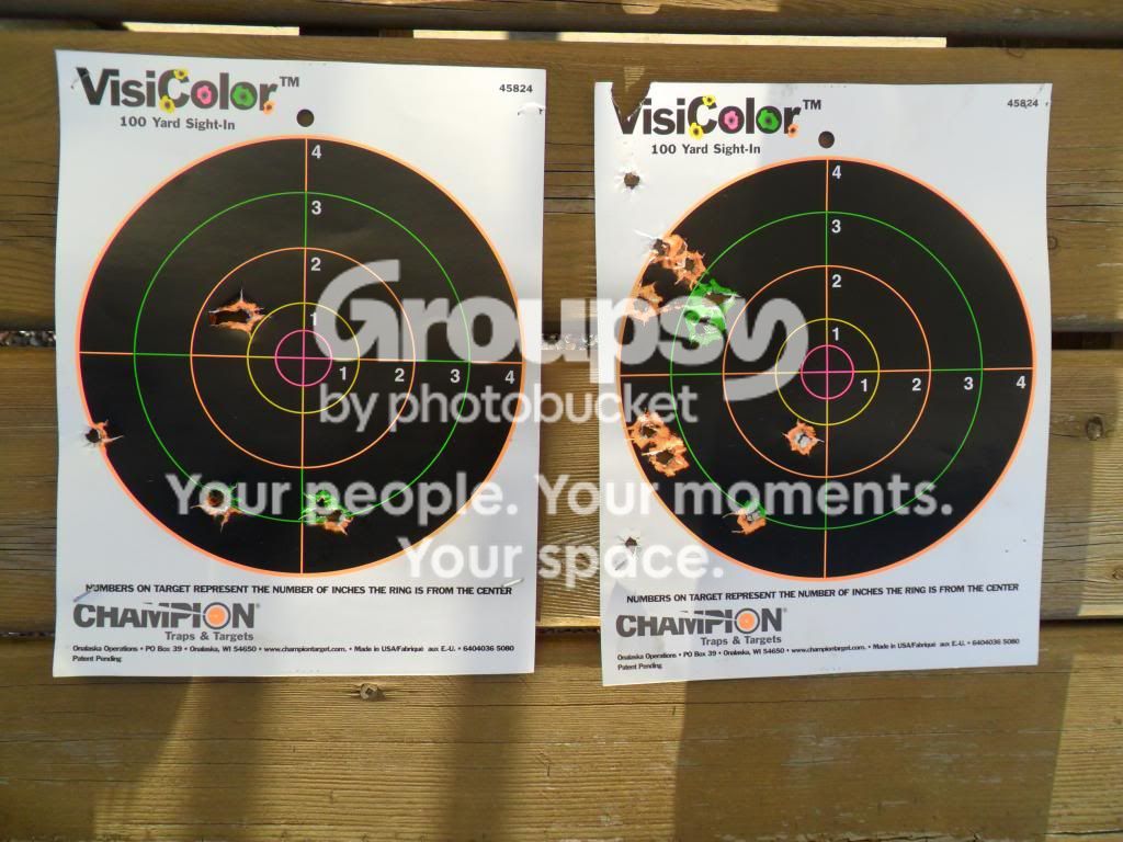

The left hand one was the first target. The right hand one was my and best third target after a sight adjustment of three clicks up versus the first try.
20 yards. Slowly getting better, still have not found THE load for it.
I find with the plow handle grip, it's like starting revolver shooting from square one again as I rarely shoot SA.
I am getting the impression that BP handguns perform their very best from a clean barrel.
Maybe or maybe not??
