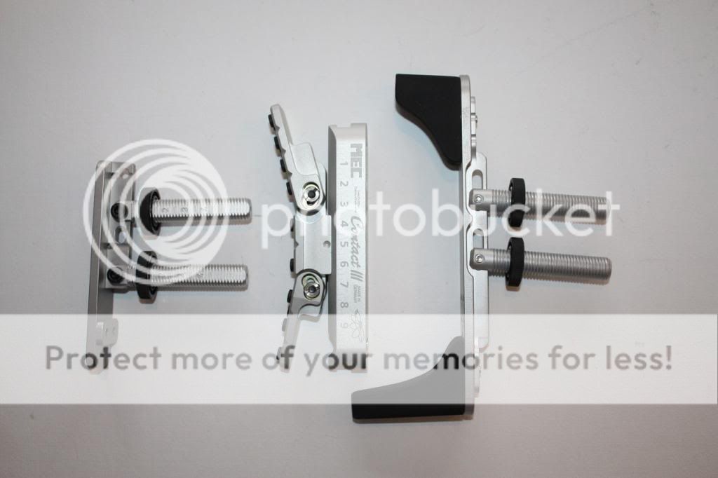

Mike,

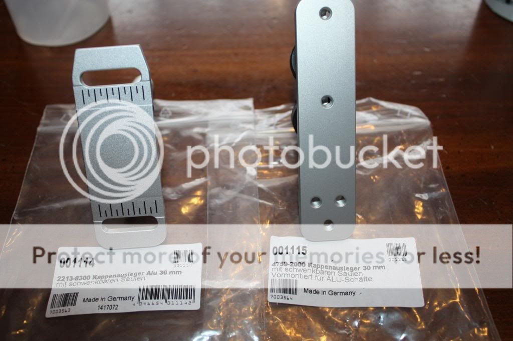

Having problems with my PC sending email so I am sending some info this way. I could do it with my ipad, but they suck for photos!

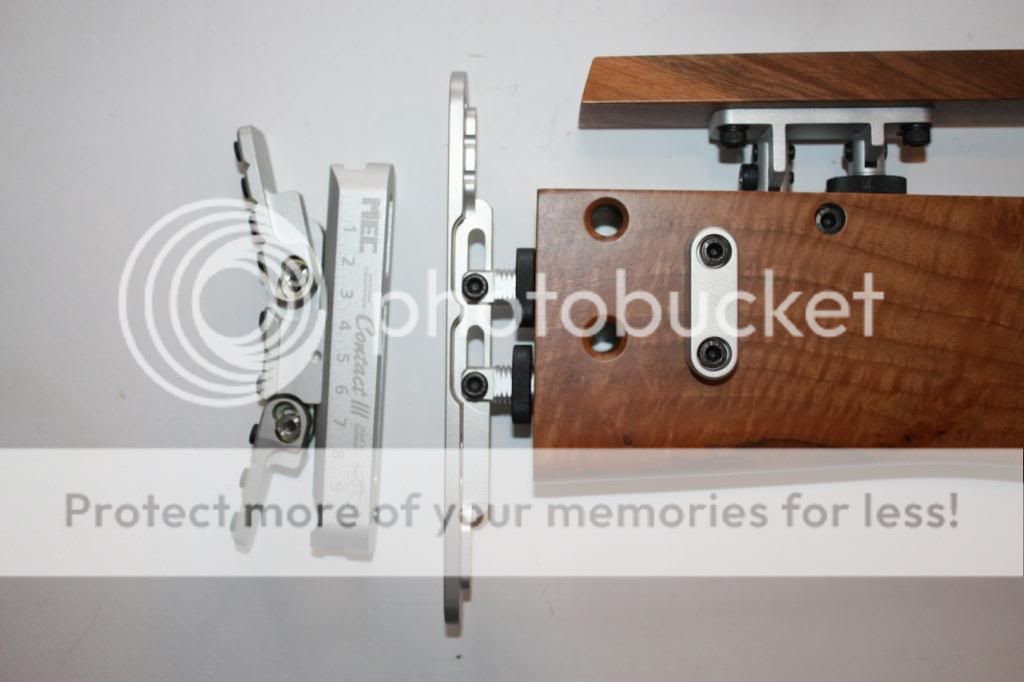

First off, the butt plate that comes with the 1827 will not work with the MEC Contact III unless you drill and tap it. The drilled mounting holes
in the original Anschutz plate will not line up with the MEC butt plate....good for butt hooks, but not for these.
The anschutz mounting plate # 001115 is ideal both in length and width for a nice fit on the Contact III

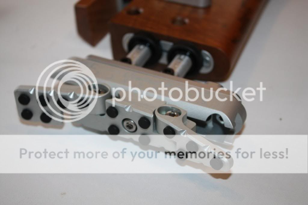

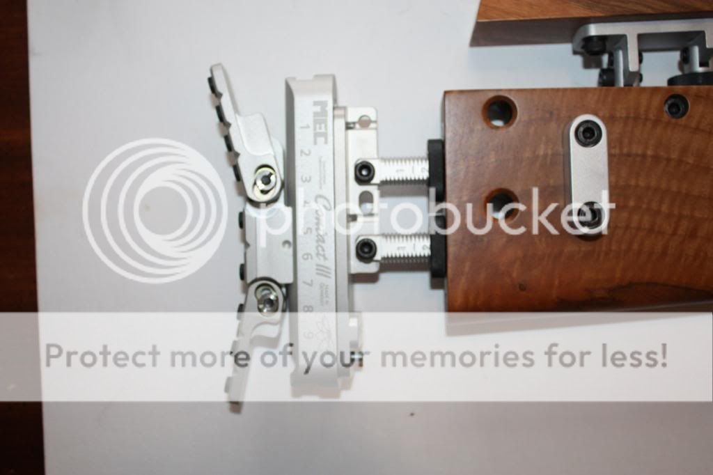

With the extra depth of the Contact III you may not need the longer columns, see photos, you will see what I mean!

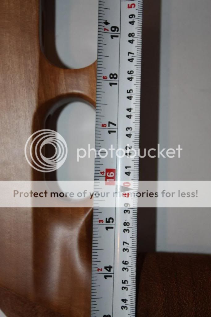

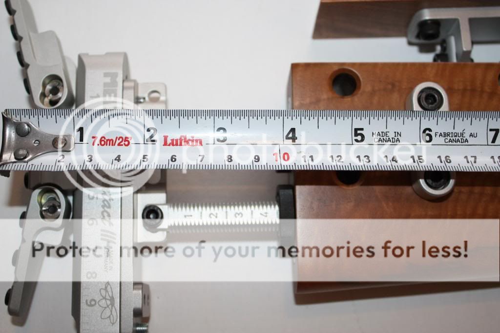

I maxed out the original columns on the carrier and you can see the overall length you now have. To the ftont of the hand grip 36cm
and roughly to the trigger (depending where you have it) 42CM to the center position.
If you need more photos or pictures, just let me know. Hope this helps!
Brad
^ This is the type of service I was talking about! Nice when the dealer can show proper fit and LOP etc. :D Thanks Brad order is in!
