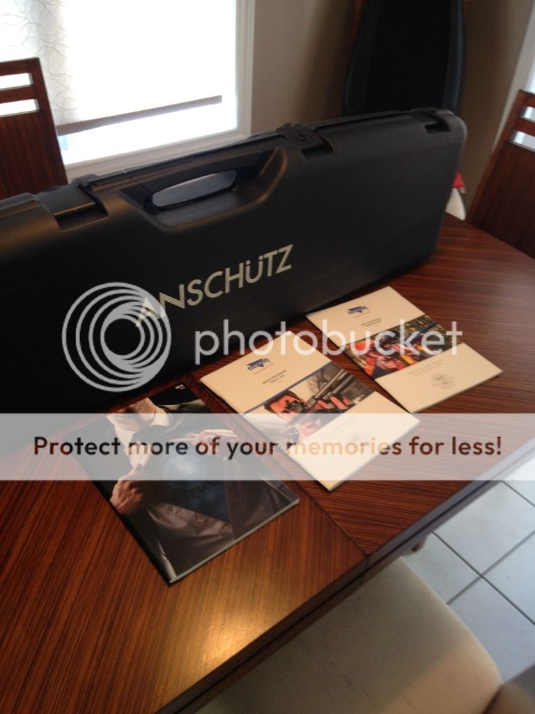

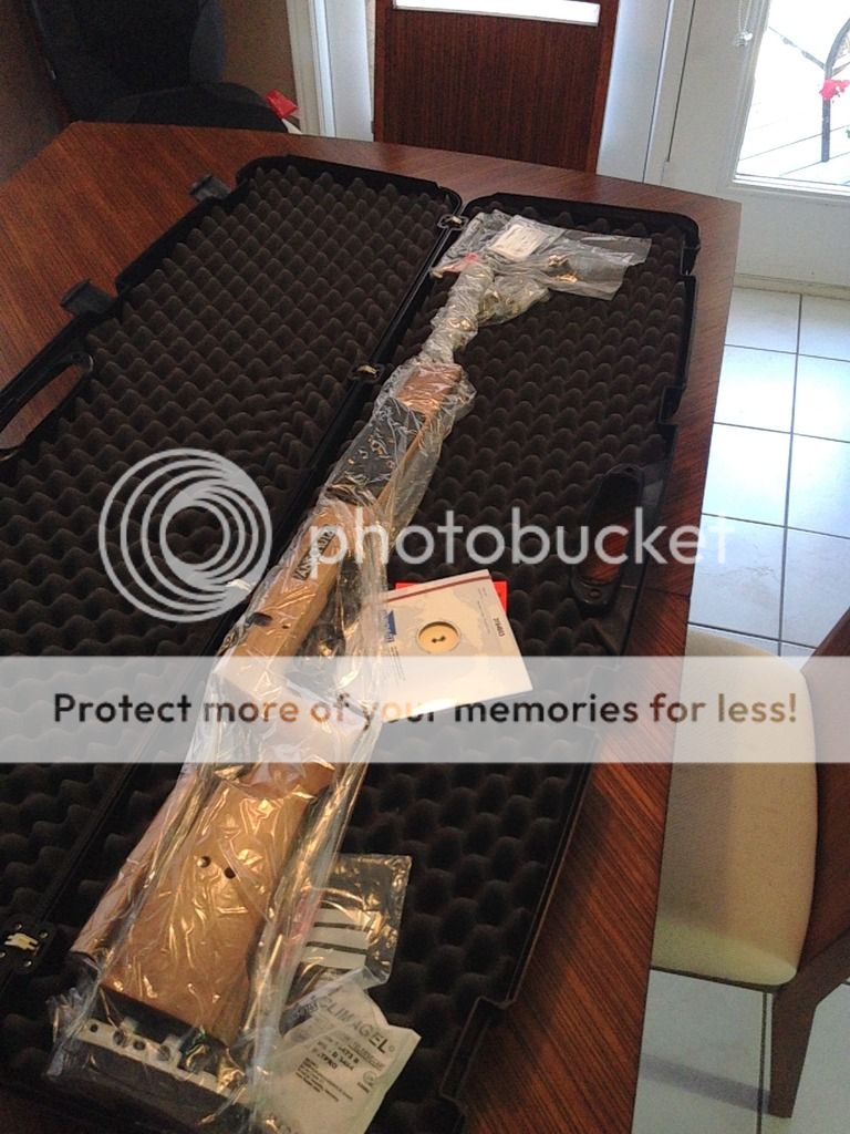

It was packaged very well from Nordic, not to mention shows up in a hard case inside the box. You also get some 2016 catalogs, Test target, owners manual CD and appropriately sized flat head and Allen key.
This rifle is alarmingly light weight and well balanced. It is as if there inst a barrel on it, the weight that it does have sits in close to the chest.
The adjustments are superb, you can adjust the cheek piece much lower or higher then you would ever need, so it truly will fit anyone or any optic. The butt stock piece is fully adjustable also. You can extend or shorten the length of pull to your desire/fit the shoulder pads hight can be moved up and down to fit your body, it can also be canted. So if you have a high cheek piece you can adjust the rifles shoulder piece so it isn't in your armpit, you can adjust it to your shoulder pocket for any type of position. It is the most adjustable but stock I've ever had. It moves in any direction you need it to. Makes it very comfortable and easy to get behind.

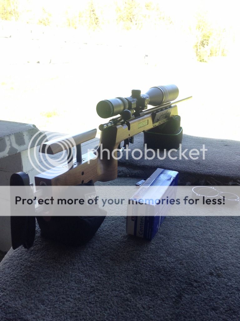

I decided to just put a Vortex Crossfire 2 6x24 50mm optic on top of it. With the low mounts I have about 1mm of clearance from the front objective lens and the barrel. Perfect right?! You want the optic as close to the barrel as possible! Yes, but my lens cover caps don't fit... So just a quick cut of them on the bottom and we will be snug as a bug again.

Shooting from Front rest, rear bag... (front rest is actually a rear V shaped bag meant to be a rear sand bag...)
I forgot to grab different types of ammo, so I only had lapua Center X on me. (that will come, I'm going to try to get out again on Sunday)

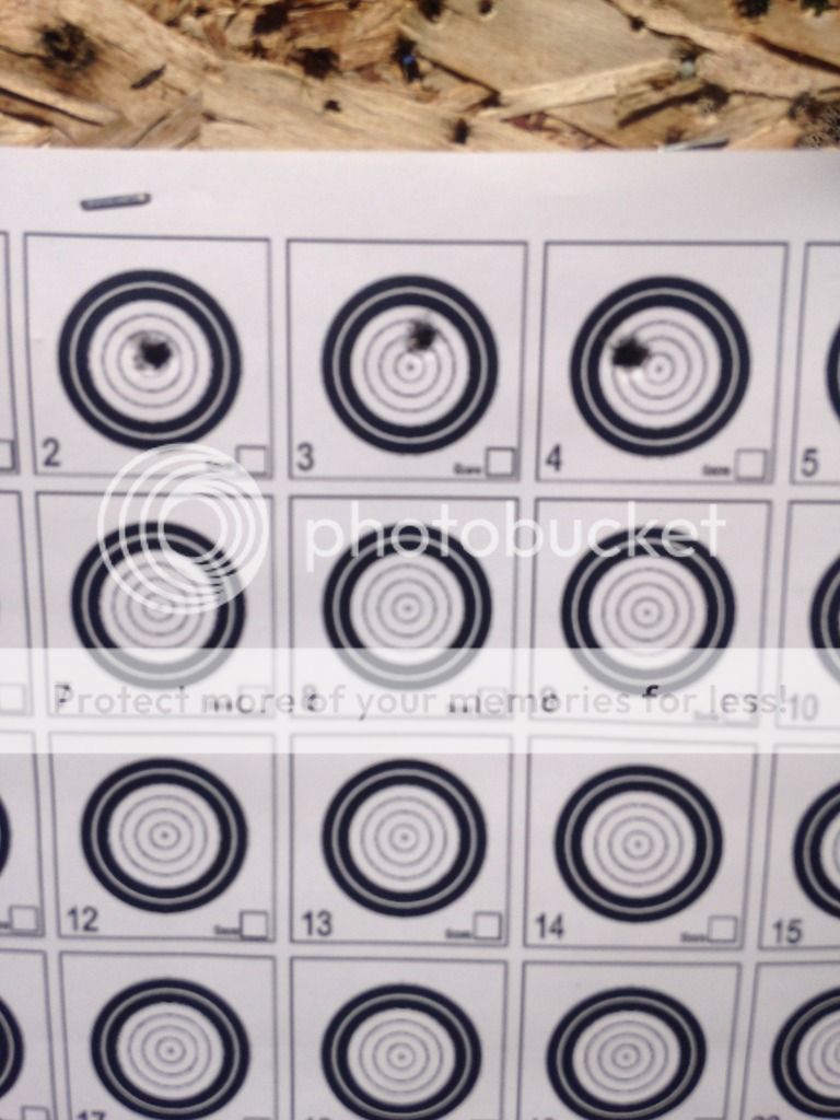

I lay down 2 groups both come in right at .200 of an inch. Now im giddy with excitement. So i quickly make the needed adjustments to my optic. Then spend the next 190 rounds chasing groups.

1st group (5 shots in the .250 inch area)
This is when I would tighten my grip and hold the front of the rifle down (by the stock, nothing touching the barrel) and muscle it into staying put. 1 shot at each target...

As for vertical stringing, I'm sure you've checked all the action and scope screws already, take a look at your rear bag. I've been finding that inconsistent rear bag pressure and stiffness induces vertical. Best way to check is to get your crosshairs on the bullseye and move the rifle back and forth on the bags. If your rear bag isn't compressed enough you'll see the crosshairs rise. This will induce vertical on recoil, even if you're only shooting .22 lr.

Cool. My thoughts on the vertical, seeing your rest setup, is that positioning the front bag right at the tip of the fore stock is just priming the rifle for stock bounce.
Perhaps next time out, try pulling the bag right back towards you, as close to the mag well as possible, and see if that settles down the vertical without having to death grip the rifle.

Yah, once i get a bipod going and a proper rear rest. I dont think I will see that happen. Used to being able to load bipods. I use a bipod 95% of my shooting, 3% (yote hunting) from sticks and 2% (tree rat chootin) free hand

Thanks, I really am. For the amount of wind today im very happy with my groups. The stringing up and down was 100% my shooting. Once I get it fully set up I will be snug as a bug.
