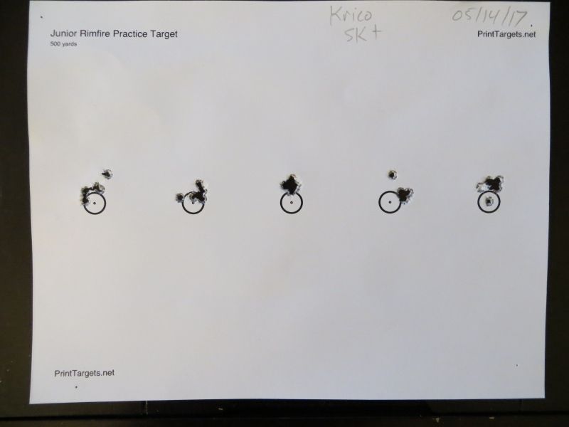

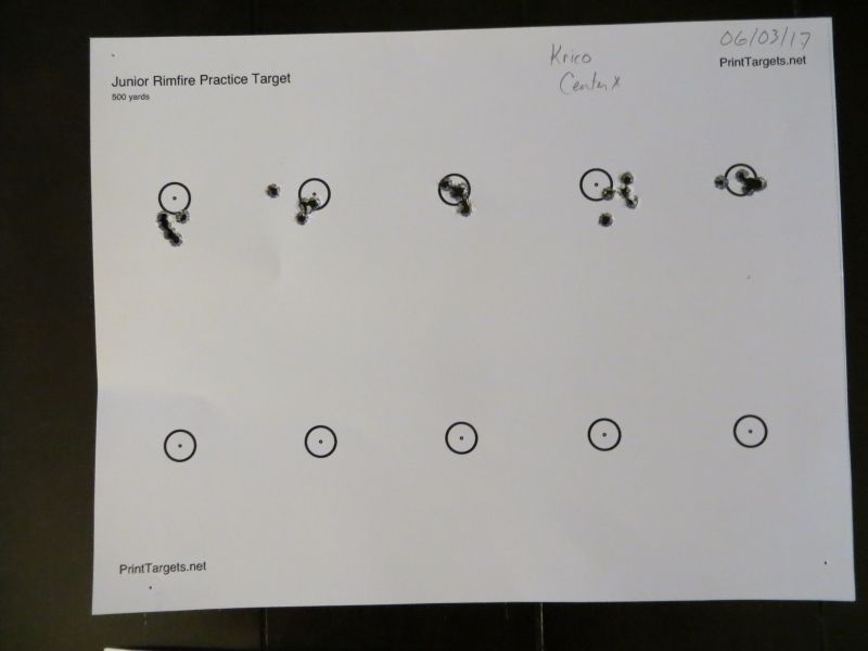

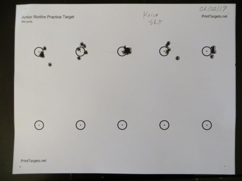

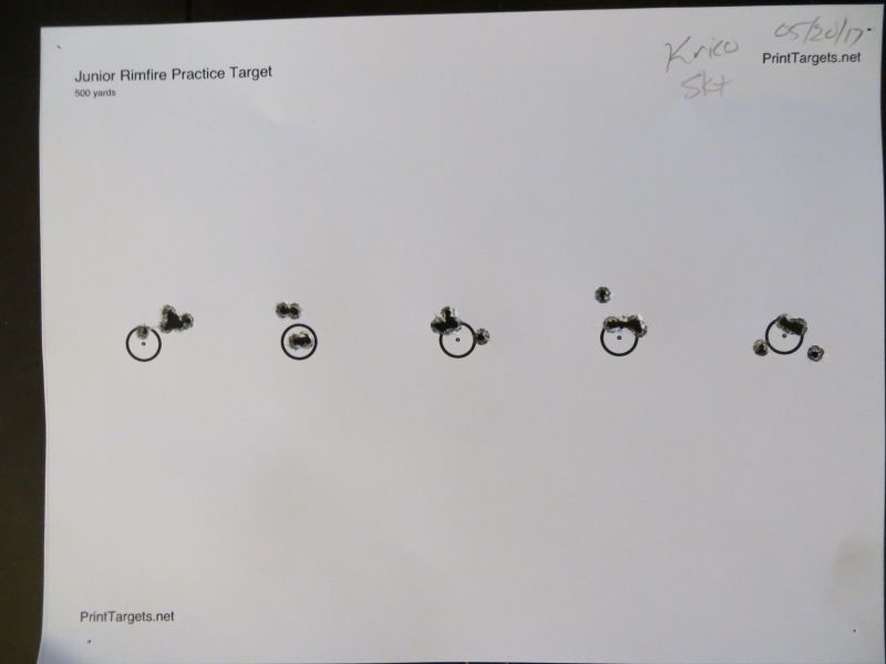

Here are a few targets from the past couple of weeks that illustrate what I'm saying.

I've shown this target here and there, but here's SK +, Rifle Match, Center-X and Midas + shot through a bare barrel. My chronograph says extreme spread and standard deviation numbers for the ammo are very close, average velocity is different between them all however. It's amazing how the consistency comes right in with Midas +, seen this several times, other ammo shoots junky then Midas saves the day. Not a matter of "hold sensitivity" here at all, and that's with a lightweight sporter.
Playing around with a tuner I was able to get the SK ammo to group much better, but more weight might be needed on it to really dial it in. Not sure how much more I'll experiment with it on my XXII, since the tuner is going on a different rifle permanently in just a few weeks.
Anyway, that's my take, just a couple of ammo picky rifles :)

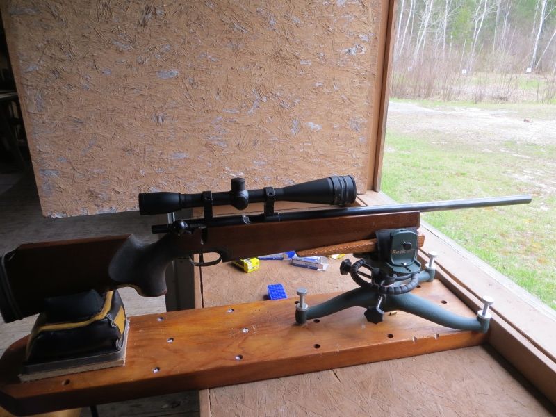

My XXII is currently my only functional .22 LR, barrels for the builds are on the way, so I have no further comment as other rifles/barrels I own have been great disappointments. I hope to have an answer for that in the coming months.

This is what I heard a lot so I went with a brick of center x and it just throws them randomly... Will layer a few right in the same hole then throw two down into a different hole... You can see it in the pic! Its so confusing! lol
Ck, thats a nice looking Annie you got there and the targets or ''down the rabbit hole as you say'' is addicting to say the least ;)
