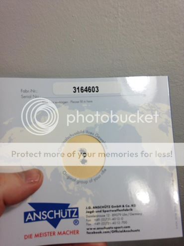

SO!
A inquisitive buyer put me on this track! I never really looked at the original target.
Turns out it is displaying the same characteristic. With the vertical spread.
Contacting the business where I purchased it from to see what can be done.
Add has been taken down! lol
Photos of the origonal target, clearly showing the issue I am having... (so those who doubted my shooting and thought I was the problem can take a hike! lol)
As far as I'm concerned a proper pillar bedding is essential to accuracy in just about any rifle, mostly this type, my MPR 64 didn't shoot worth a crap out of the box, but after I fixed it up, no problem.
Second thing, any scope even brand new out of the box, even on a .22lr, can be a bad scope.
The issue you're having there is not ammo related, nor ammo fixable.
I'll never run crappy cheap bulk ammo through a match rifle, always good match ammo, lapua or eley.
Trust me, ive been trying lapua and eley match grade ammo to no avail. Just have to keep playing.
So, got the word back! Id like to thank Nordic for their phenomenal customer service! Always super quick in getting in contact with me. I have never had an order go wrong or ever been disappointed by them!
My group is not some some odd ball group. The target passed the accuracy test! So my rifle should be able to do this! lol
(18mm Is the required group size, I didn't catch the distance. I wonder with what ammo ?)
Basically I need to keep trying ammo out and one will be what works.
The brick if Midas + should be here in a couple days then back to the range. I was also recommended in playing with the torque settings...
I generally find an ammo the rifle "likes" then tune in the torque settings. Is that how the rest of you do it also?
