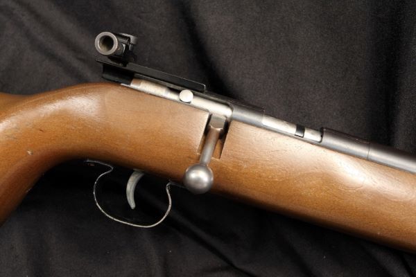

The OP's rifle is a Flobert action Anschutz, probably an Anschutz 1400 or a CIL Anschutz 125 (the same rifles). The Flobert rifles were the most entry level of Anschutz rifles, whether sporter or target models.

The Anschutz 1450 is a Flobert action Anschutz, just like the OP's.
The simplest and easiest way to distinguish a Flobert action Anschutz from a 64 is to look at the bolt handle.
Below a Flobert action Anschutz. The Flobert bolt closes in front of the trigger.
The 64 action Anschutz rifles below show the bolt more in line with the trigger.
