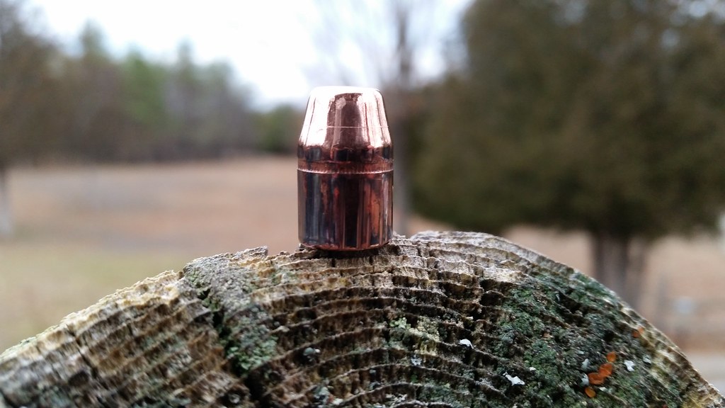

From an old post of mine on my 12" barrel Henry Big Boy
Recovered from a tree stump:
Experimenting with IMR 4227 powder starting with 22gr to 23.5gr under a CamPro 240gr TMJ TC. A perfect day with no wind and -4*C. Looks like the best load is with 22.5gr of IMR 4227 at 50 yards... 1/2" group. Powder was individually weighted with a RCBS scale. Bullets not weighted.
