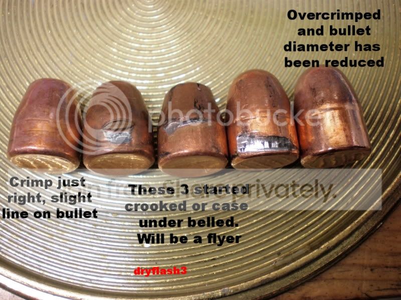

CAMPRO bullets are plated bullets and a heavy roll crimp or excessive taper crimp will distort the bullet and crack the plating. I bought a Lee carbide factory crimp die that "taper" crimps my plated .44 Magnum rounds for my 5 inch S&W model 29.

The photo below is from AR15.com and posted by their very knowledgeable moderator.
As you can see below plated bullets are very sensitive to over crimping and can be damaged during seating. The thinner the plating the more sensitive to crimping and velocity range.

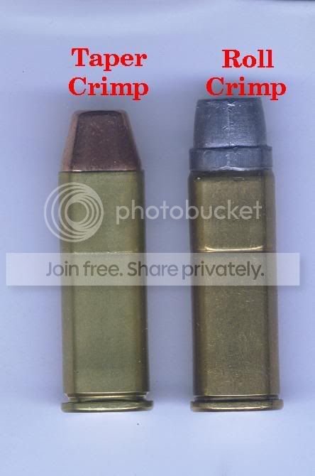

And again keep it simple, plated bullets with light loads and a taper crimp, and hot loads with jacketed bullets and a roll crimp.
