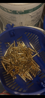

This is an hour of tumbling , pockets clean.
I reinvented the wheel because I got a flat….pins stuck in cases etc. cost was 60$ vs 30-90$ depending on how many pins you want.
By all means stick with pins if they are working for you I was just showing another way. If it isn’t broken don’t fix it…for me it was broken so I fixed it.
The balls got them as clean as the pins in an hour so not sure how the pins are way better?
