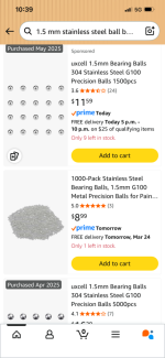

I am going to get some SS balls and try it. Seems no matter what I try, I always fight with a few pins dried into brass at some point,
Here I go again hehe
After a couple batches with pins I wasn’t loving it so my overthinking brain went to work again and decided to try ball bearings out.
First go was .5 mm and it was smaller than sand so sent them back and got 1mm, still looked too small. With the goal of still being able to fit through the flash hole I ordered 1.5 mm and goldilocks found his porridge!
Theres no need to use a magnet just rinse in a small bucket and pour into a shallow container with some blue shop towel to dry and pour back in the tumbler next time.
Cleans primer pockets just fine and no peening of necks or any other negative.
Just thought I would share as maybe others aren’t loving the pins as well. View attachment 1114698
I don't imagine you got a Amazoom link ta yer' balls do ya? lol
I am just getting into the reloading world and thought the idea of ball bearings was way better than pins, I am glad you are having success with them!
