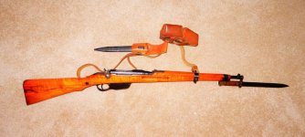

Sadly now gone, my first M95, a Budapest stamped gun. Not surprisingly to some I am sure, bought it from Century back in the day, with a bundle of ammo at .25$ per round. The sling, bayo, original style cleaning rod, frog and ammo pouch all came from Germany around 93/94. One of the ones I sometimes wonder why I sold it.
