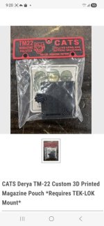

Can you post up some pictures of the Derya pouches you speak of
These are made by a guy I shoot with fairly regularly. Makes several items for the TM22 that are actually pretty decent.
I run his magwell, charging handle, magazine release and I need to get one of his mag loaders.
Not a very good picture of the pouch but you get the idea. Screenshot_20260221_092026_Samsung Internet.jpg
Not a very good picture of the pouch but you get the idea. View attachment 1097706
I can see why you don't realy like them. They might work better if you take them out of the bag.
